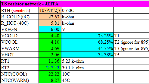

I see the application of TS on the datasheet. the temperature range are 0~60 degree C.
how to design the temperature(T1-T5) from 0 to 45 degree C?
EX: For my understand: Assume T5 -->60 degree C =2.996Kohm Change it to 45 degree C =4.867Kohm
Is it ok for my understanding?
