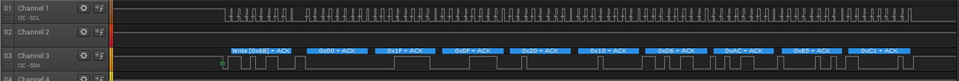

My customer has a question on muti-write function. They want to know if multi-write command would be kept in IC once Stop bit is not sent to IC. If no, how many commands would be kept? For example, does the previous 5 commands would be kept if we want to send 6 commands to IC and I2C pull up power drops when we send the sixth command?

  • Hey Ann,
    In regards to the I2C multi-write, sending a STOP command will stop the I2C transaction.
    You can refer to Figure 26 in the datasheet. The letter "P" refers to the I2C STOP condition. You can write to each successive register up until that STOP command.
