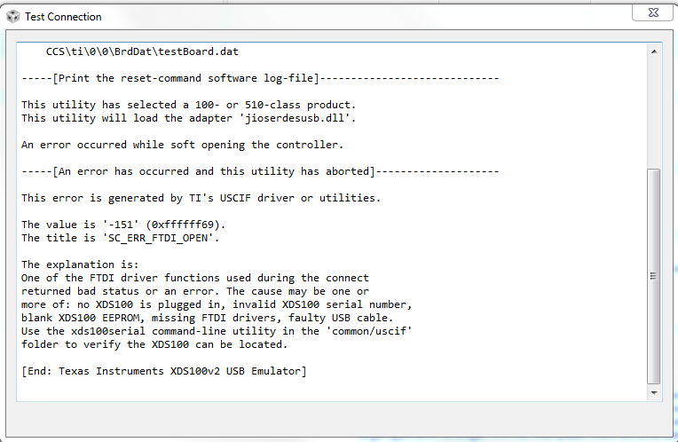

I am following the TIDM-TMS570BMS example and have performed the necessary modifications and before programming the board I am able to test connection and receive this message: "The JTAG DR Integrity scan-test has succeeded." However, after programming the board I am able to open the GUI but when I retest my connection I receive this error message

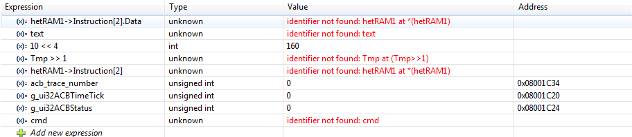

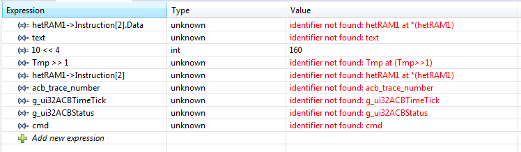

Additionally under the expressions tab there are many error messages as shown below:
The main issue im having is not being able to balance, the cell voltages are able to be read however when balancing is enabled the voltages do not change. I confirmed using a logic analyzer that SPI signals are present so I suspect it is a programming error. Any help would be appreciated
