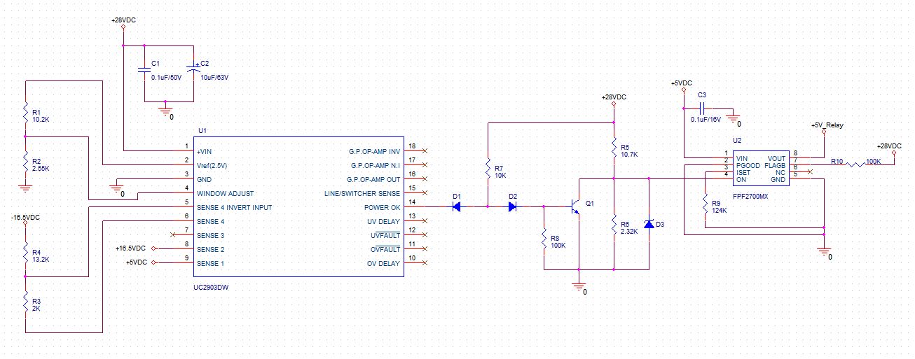

I need to use the "Power OK" output of UC2903 to activate a load switch (The load switch requires an active low signal on the "ON" pin to enable VOUT. The VOUT needs to be disabled when the monitored power supplies fall out of tolerance). I'm monitoring three DC power supplies viz. +5V, +16.5V & -16.5V and my Input Supply is +28VDC. The fault window has been set for a tolerance of +/-5%. I'm not getting the desired "Power OK" output to activate the load switch (the "Power OK" output is always LOW).
Please review my implementation of the power monitoring IC and suggest any improvement, if required.

    Can you test the functionality of the "power ok" without the diodes but with a pull up to see if it works?
    I want to make sure the device is functional then we can work on the secondary side
    -Marcoo

    I have de-mounted D1, D2 & R5 and I have put a jumper at the place of D1 (pulling-up the "Power OK" output to 28VDC through 10k resistor).
    But, I'm not getting the desired voltage at the "Power OK" output.

    I believe the "POWER OK" output is also tied to the "LINE/SWITCHER SENSE" input as well. The LINE/SWITCHER SENSE is internally referenced to 2V so when this input is less than 2V, POWER OK will be active low to show a fault. When LINE/SWITCHER SENSE is above 2V, POWER OK will be logic high to show no fault.
    Please confirm this is the issue you are seeing. Thanks!
