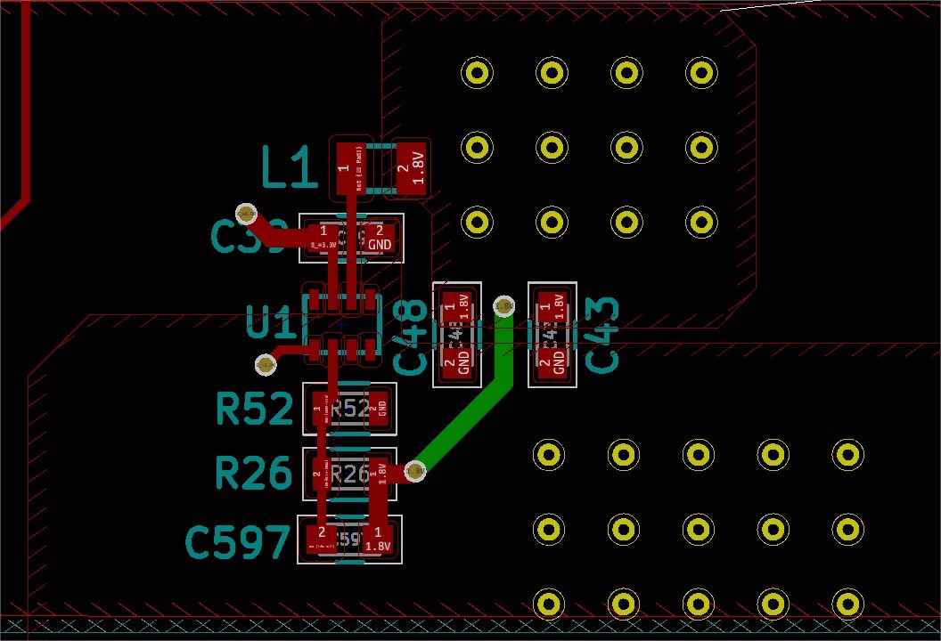

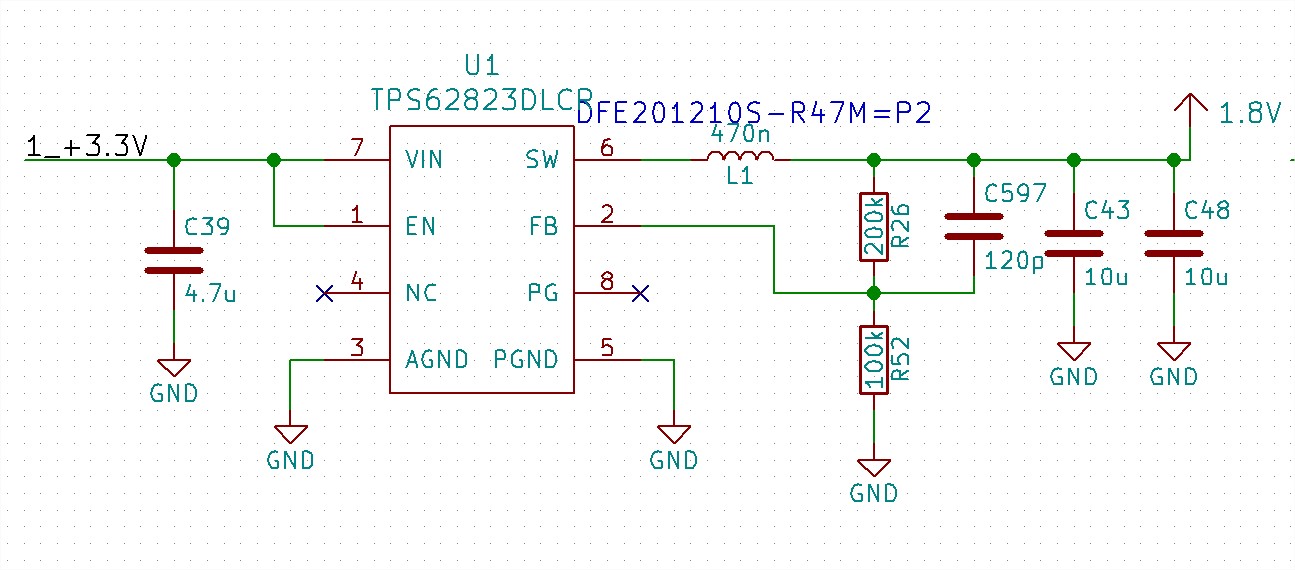

I am using three TPS62823DLCR for my design
One for 1.8V output, two for 1.0V output
I will need around 2A for each voltage

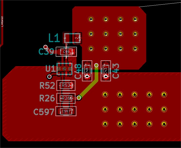

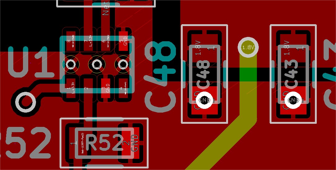

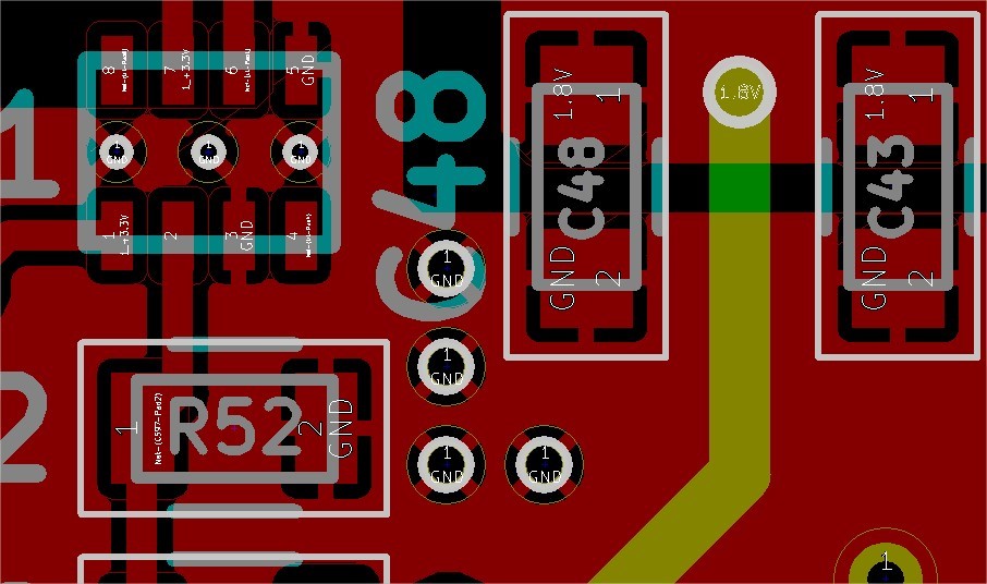

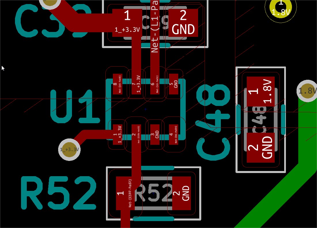

Here is the design I did, schematic and layout (same design for each voltage):
I did one plan for my voltage (here 1.8V) and one big connecting all of my ground with via connecting those plan to my power plan 1.8W and ground plan in inner layers
I am just a little bit worry about the temperature it might reach and if it won't create a thermal spot in my board
Please feel free to tell me if you see any mystake :)
Thanks a lot !
