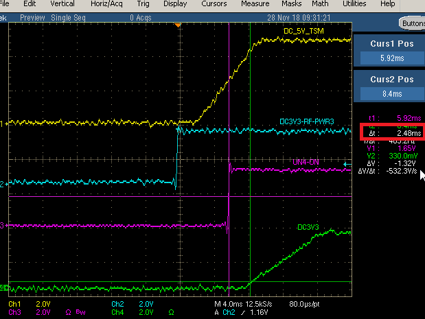

  • Hi Arthur,
    Customer test the delay time on their PCB.
    Result as below:
    According to the tD equations .
    VIN=3.3V: tD = 0.438 x CT(pF) + 104.4 = 0.438 x 3300pF + 104.4 = 1549.8us.= 1.549ms.
    Consider the variation of capacitor (+-10%) / High Temperature(-12%) / equation  (+-10%).
    The worst case calculation is 1.863ms ( max )
    But the actual measurement tD is 2.48ms.
    Customer want to know why this variation is so high.
    Shaq.
  • Hi Shaq,
    Thanks for providing additional details. The delay time of the load switch can also be affected by the load resistance and the load capacitance. If you have a larger output resistance, it will require more gate drive until the output voltage starts to rise. For reference, you can refer to section 2.2 and 2.3 of our app note, Timing of Load Switches, for additional details.
