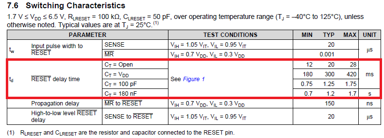

Hi Team,
The datasheet shows the following about RESET delay time.
Does the value include CT capacitor tolerance?
If so, could you tell me CT capacitor tolerance about CT=100pF and CT=180nF?

The delay is based on ideal capacitance value. The overall error would need to include tolerance based on type of capacitance being used in the system
