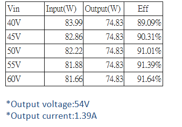

Dear Jasper,
The customer already builds an evaluation board by themselves, so your comments are quite important to them at this time frame.
They tested the efficiency, but not sure the reason why 40V have lower efficiency compared to the result from the Webench which have the highest efficiency during 40V.
My comments are 40V have the higher current which will cause the higher conduction loss, so the reason they have such low efficiency might be they choose a high Rdson MOS.
Do you have any comments to improve efficiency?
BTW, do you have any suggestion to reduce LM5118 itself loss even only reduce 0.3W?
