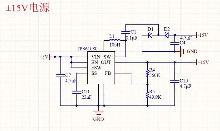

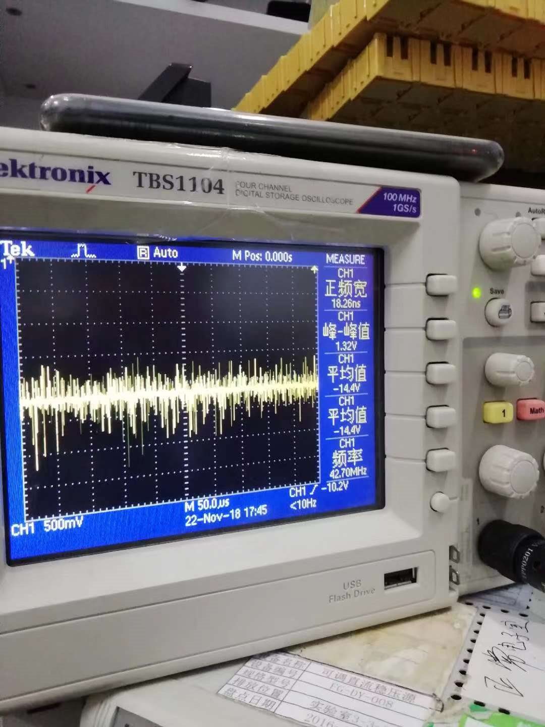

5V input power, output plus or minus 15.The output waveform of -15 was measured by oscilloscope, and the ripple was very large.What's the reason for this?How to solve

What is the output ripple of the +15V output? And what is the load current of the -15V output?

Please test the -15V ripple directly across the -15V 4.7uF cap. And you may need to add more caps at the -15V load.
