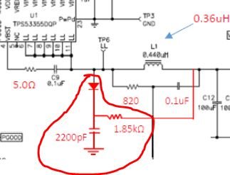

    This is the circuit diagram. (Basically, the constant of EVM is changed)
    TP53355.pdf
    The voltage fluctuation fluctuates slightly at about 8.5 V at 25 °C.
    When the voltage fluctuation is 25 ° C.
    At -40 ° C, it varies greatly with Vin = 5 V to 11 V

  • Hi Newey
    Thank you for reply.
    The red frame is a snubber circuit.
    Even without this circuit, the phenomenon does not change.
    Because it occurs particularly conspicuously at low temperature, can you check it?

  •  Hi T Kishi-san,
    1. Yes, the N value is higher because the effective output capacitance is reduced with higher DC bias.
    2. We usually inject about 15mV ripple to the FB with all ceramics output capacitors.
    One question, what is the purpose of this circuit (red circle)?
    Amnat

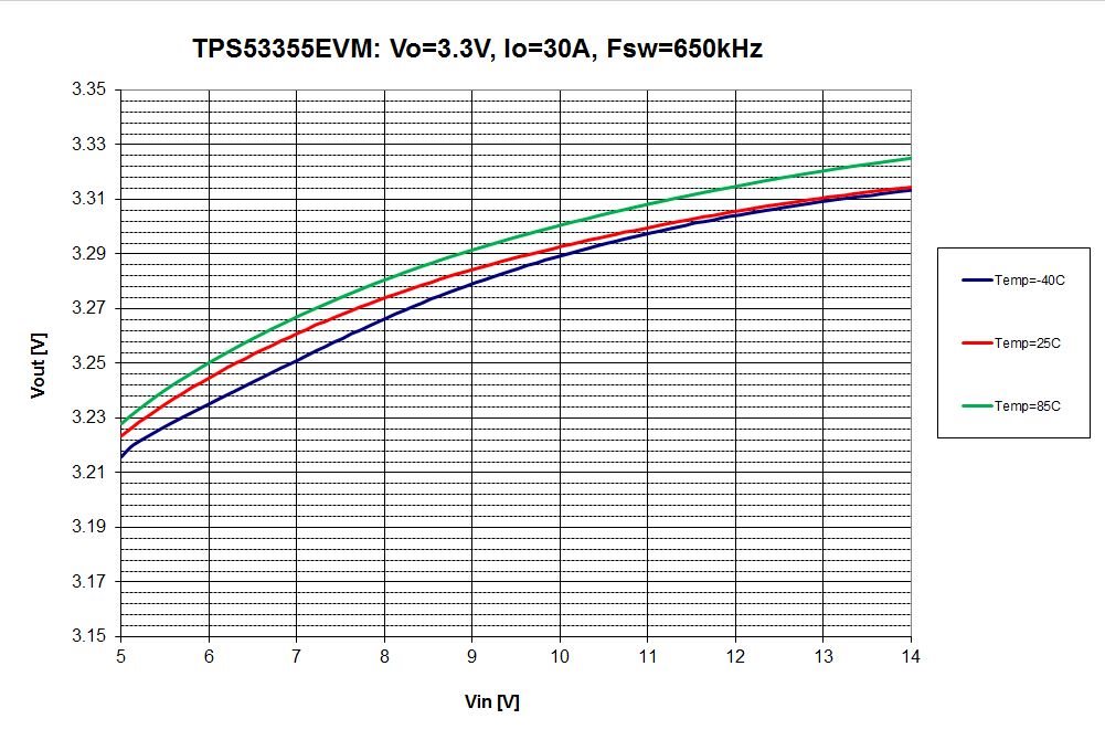

  • Hi T Kishi-san,
    Here is the data we've taking without the snubber circuit.  Your schematic was duplicated on out web-orderable EVM with the ripple injection.  We do not see the same behavior as your.  Please let us know if there is anything else we can help you with.
    Thank you.
    Amnat
