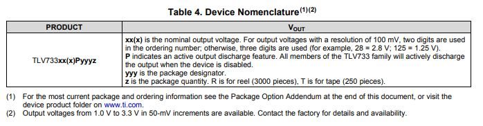

Hi, Team,
COuld you kindly help to check the difference between TLV73328PDQNR3 and TLV733285PDQNR. Please kindly help to support.
  • Hi Lucky,
    Both devices are part of the TLV733P family of devices and therefore share the same overall design and characteristics.  The difference between the two orderables is the regulated output voltage because the internal resistor divider ratio is different.
    TLV73328PDQNR3 has a 2.8 V output.  In addition the Pin1 Quadrant in the tape for this orderable is in Q3 which is different from most DQN orderables for this family.
    TLV733285PDQNR has a 2.85 V output.  The Pin1 Quadrant for this orderable is in Q2 which is the normal quadrant for the DQN orderables for this family.
