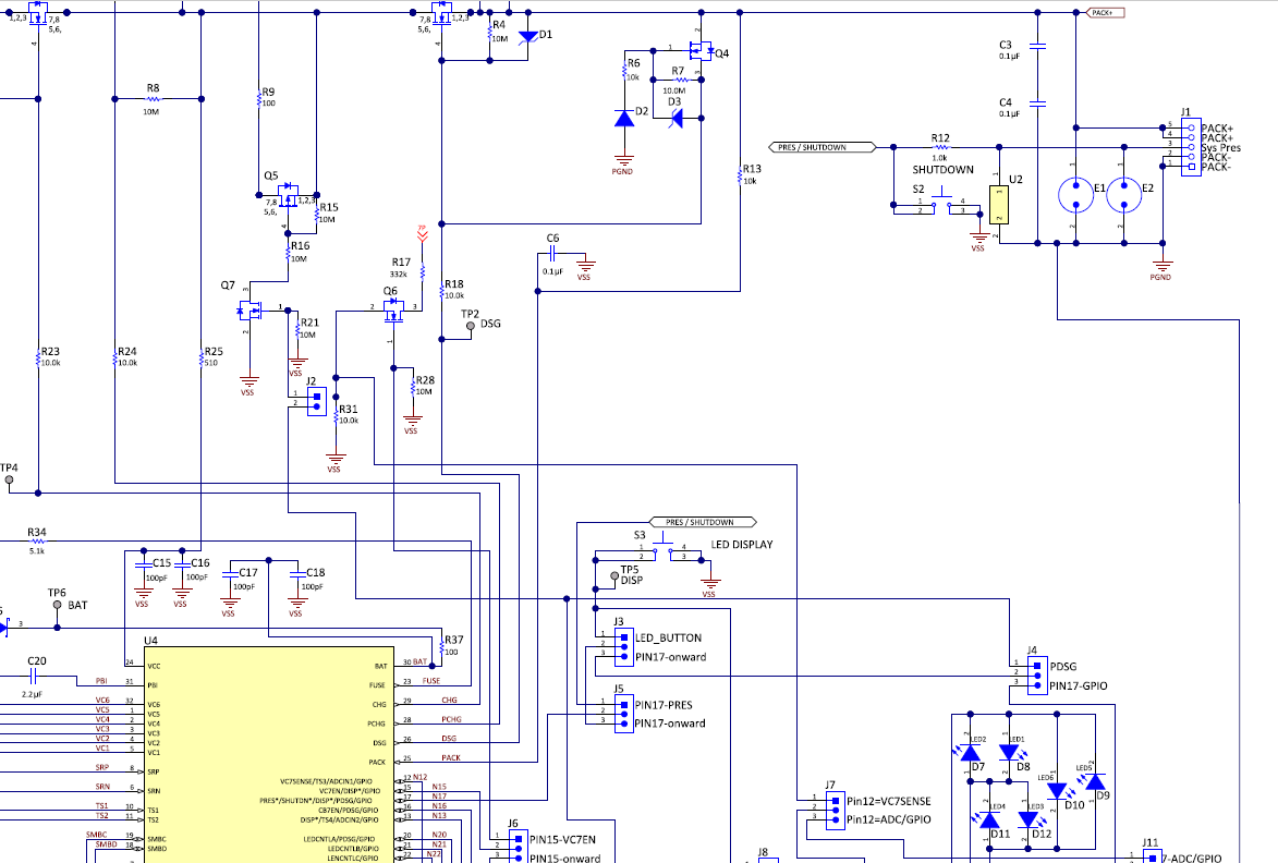

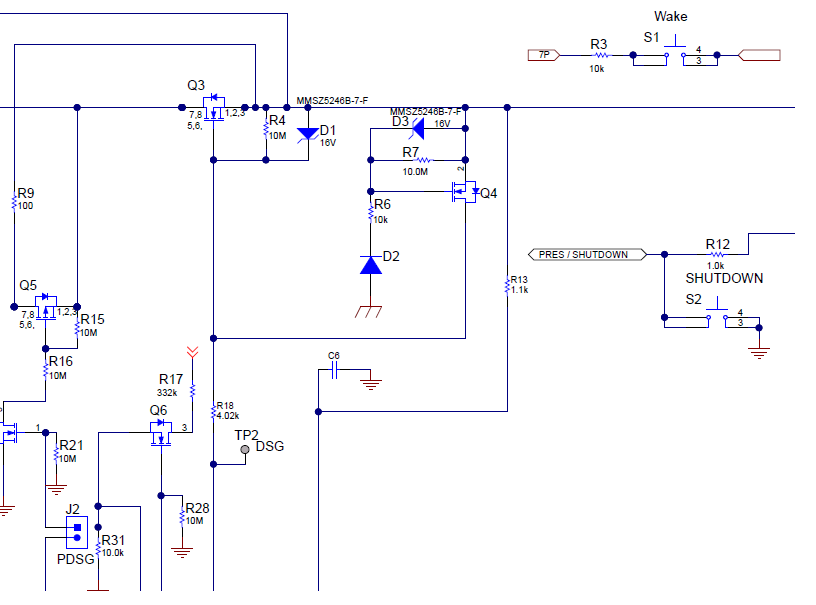

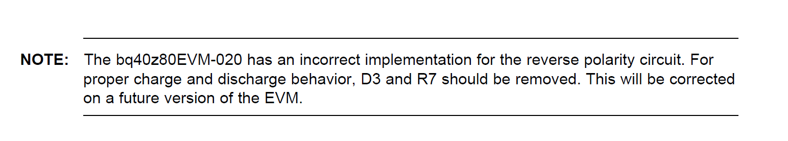

Dear TI Experts,
I found a errata message from bq40z80EVM's User's Guide as below.
I suppose this can be solved by just switching positive and negative pins of D3 in the new design and keep all other circuit the same, is this right? Thanks.
