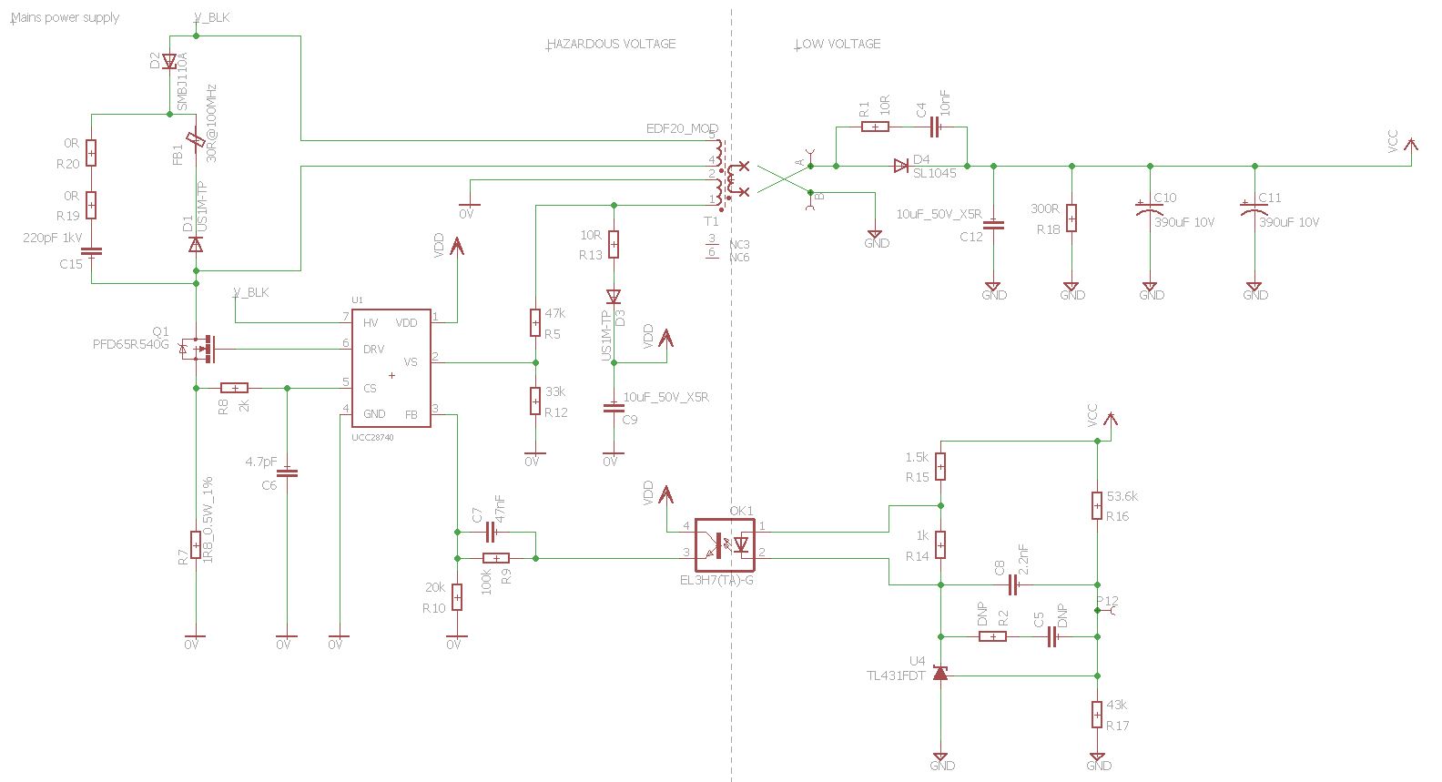

Schematics (I did not show the part making VBLK, it's standard and VBLK is stable.

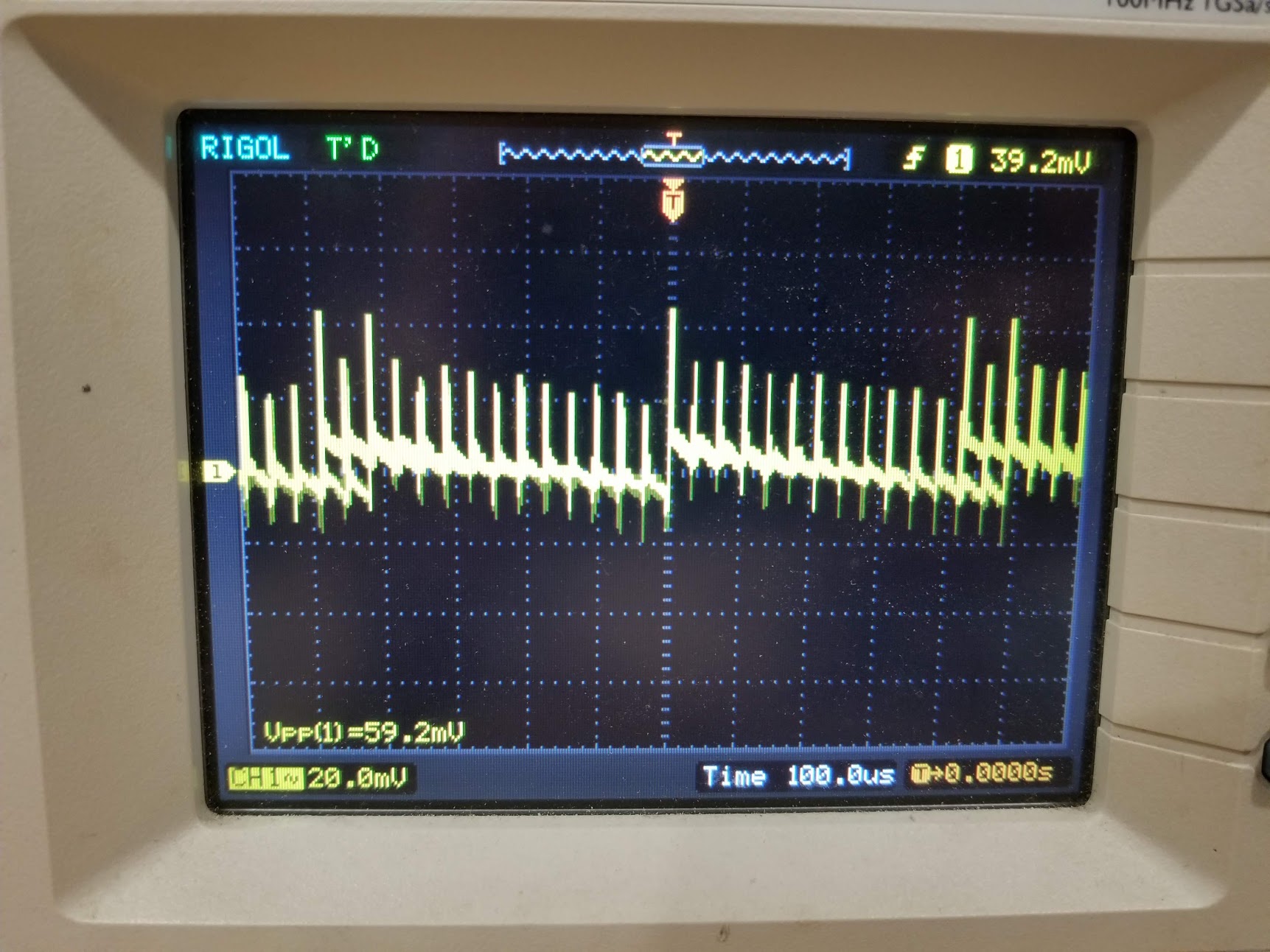

With this new version, I have two cases:

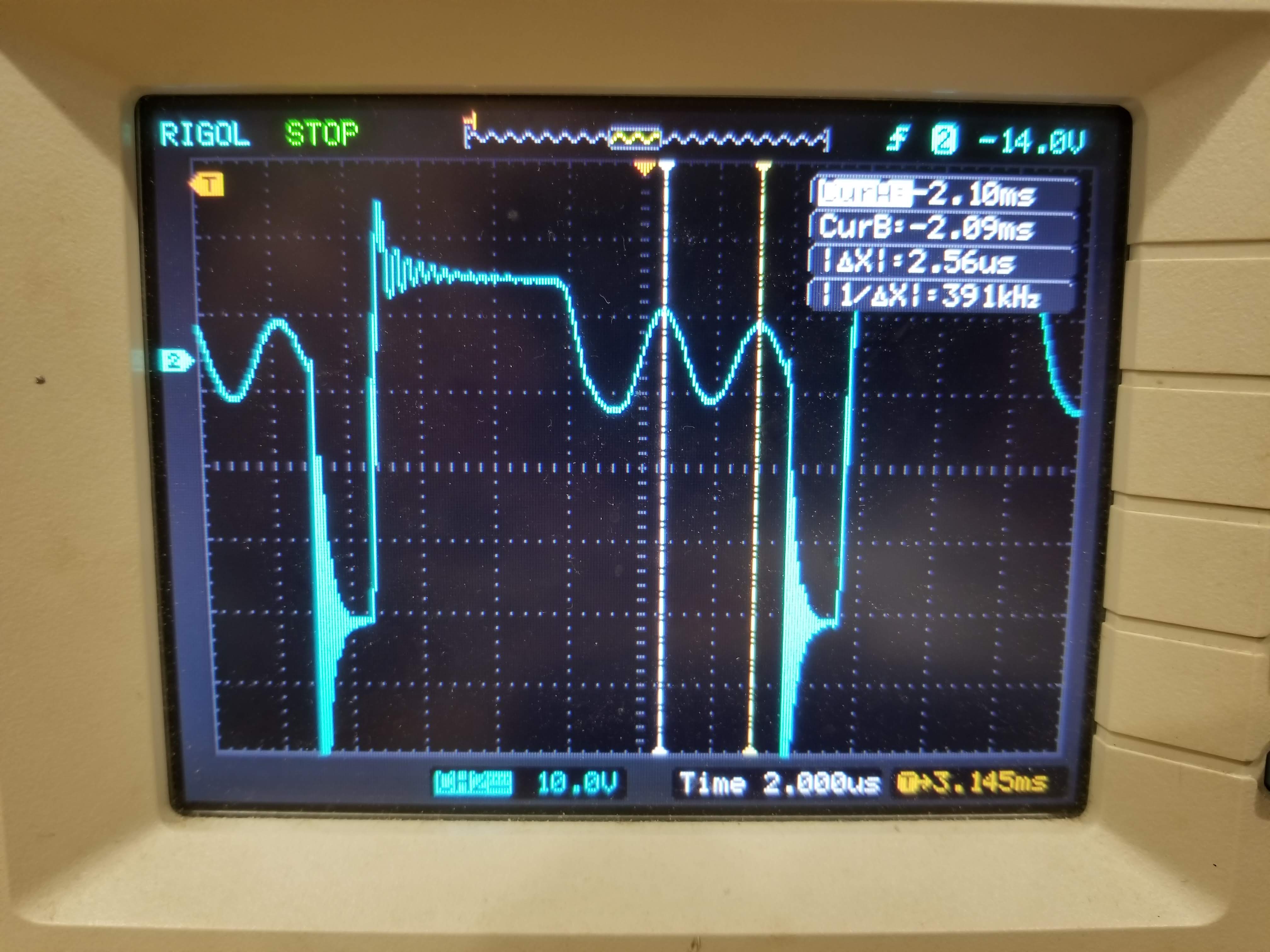

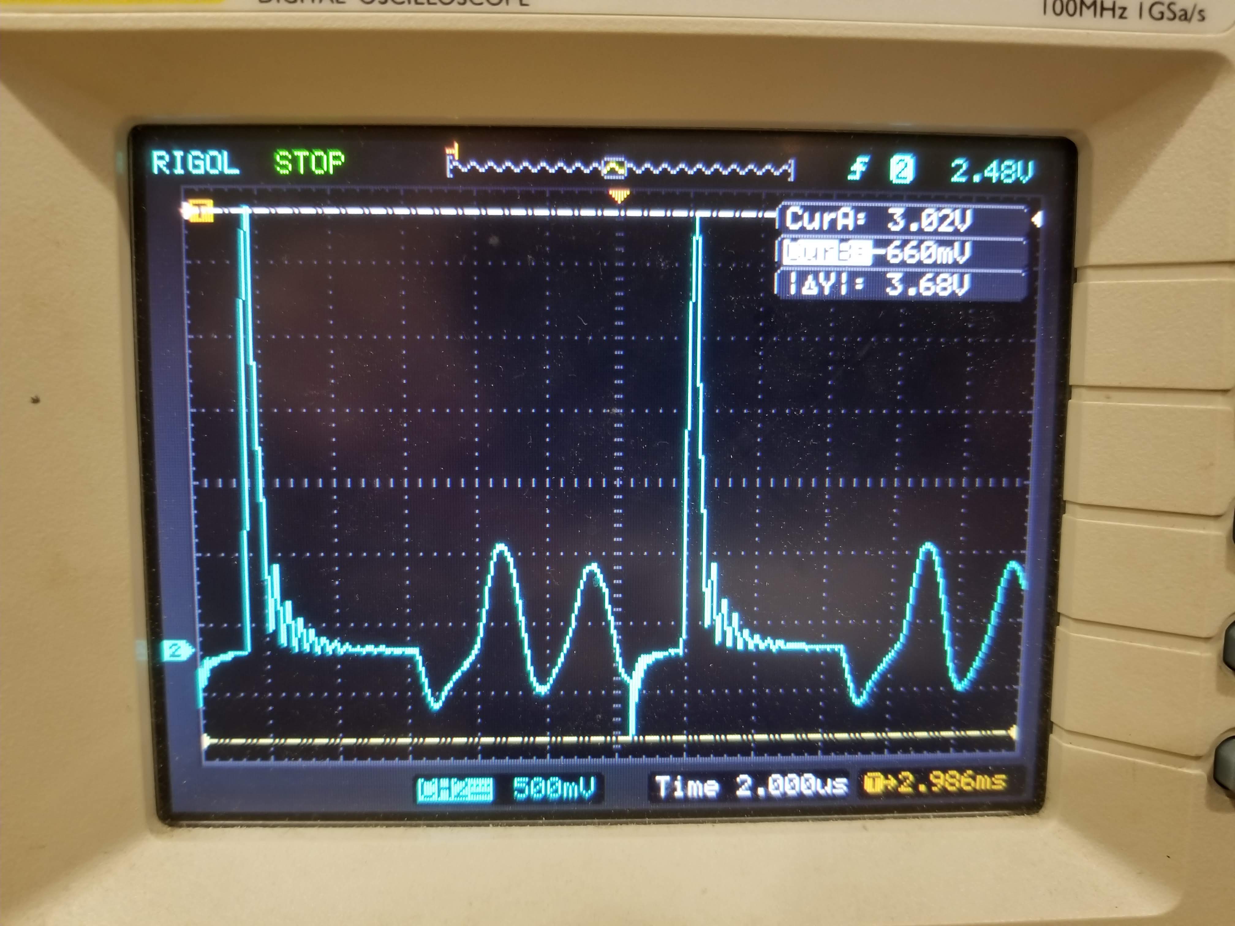

CH2: VAUX. Period of oscillation is 2.56us, larger than expected.
I measured the resonant period, and it seems to be too long: around 2.5us, while Tzto is only 2.1us.
That part is not clear in the datasheet and troubleshooting guide, as it is simply said that the period should be lower than Tzto for fear of missing some of the valley switching - not that it could stop everything from runnning.
I saw a very small number of missed valleys here and there, and if the penalty is only efficiency than I'm OK living with it for now.
Applying the formula for the resonant period (6.1 of "Troubleshooting TI PSR controllers"), knowing the actual inductance of the transformer primary, I get a Csw that, when input in the calculation sheet returns a very different (an shorter) period, so that's a bit misterious here. If that computation was good, then when I changed the MOSFET so that Coss goes from 53pF to 28pF the period should have lowered measurably, but it stayed the same as far as I could tell.
Lowering the inductance would be the opposit of what I'm looking for, and I have no control on the other parameters...

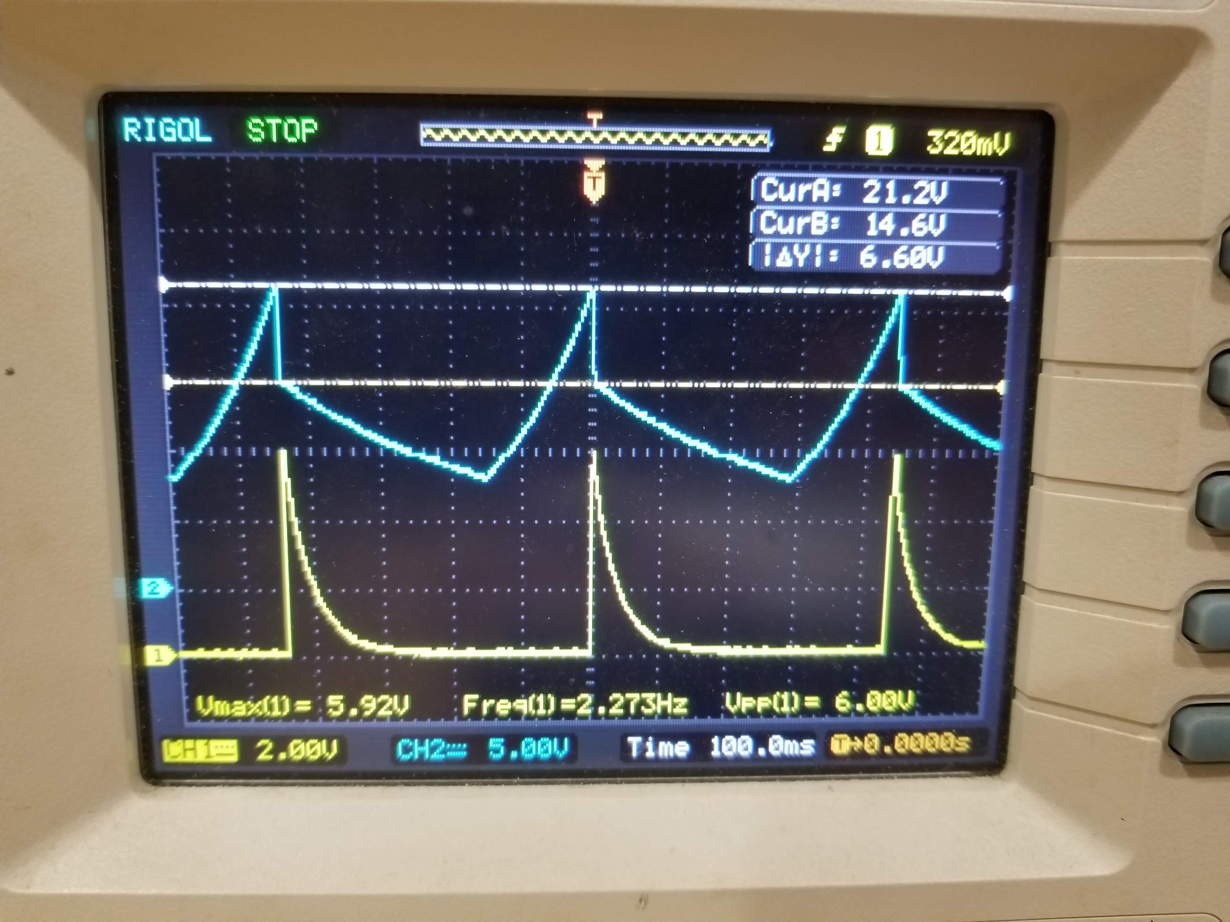

1)
The chip starts when VDD crosses turnon UVLO threshold, then it switches until the output reaches slightly above the expected output voltage, then it stops switching, seemingly due to CS overvoltage.
VDD goes from 21V to about 14.6V in this time, then slowly drifts down to the turnoff UVLO value before starting another cycle.
CH1: VOUT, CH2: VDD. Showing multiple cycles. VDD slowly goes down after the chip has stopped switching, until it reaches VDD(off) and restarst the cycle.
CH1: VOUT, CH2: VDD. Zoomed in on the time during which the chip is running.

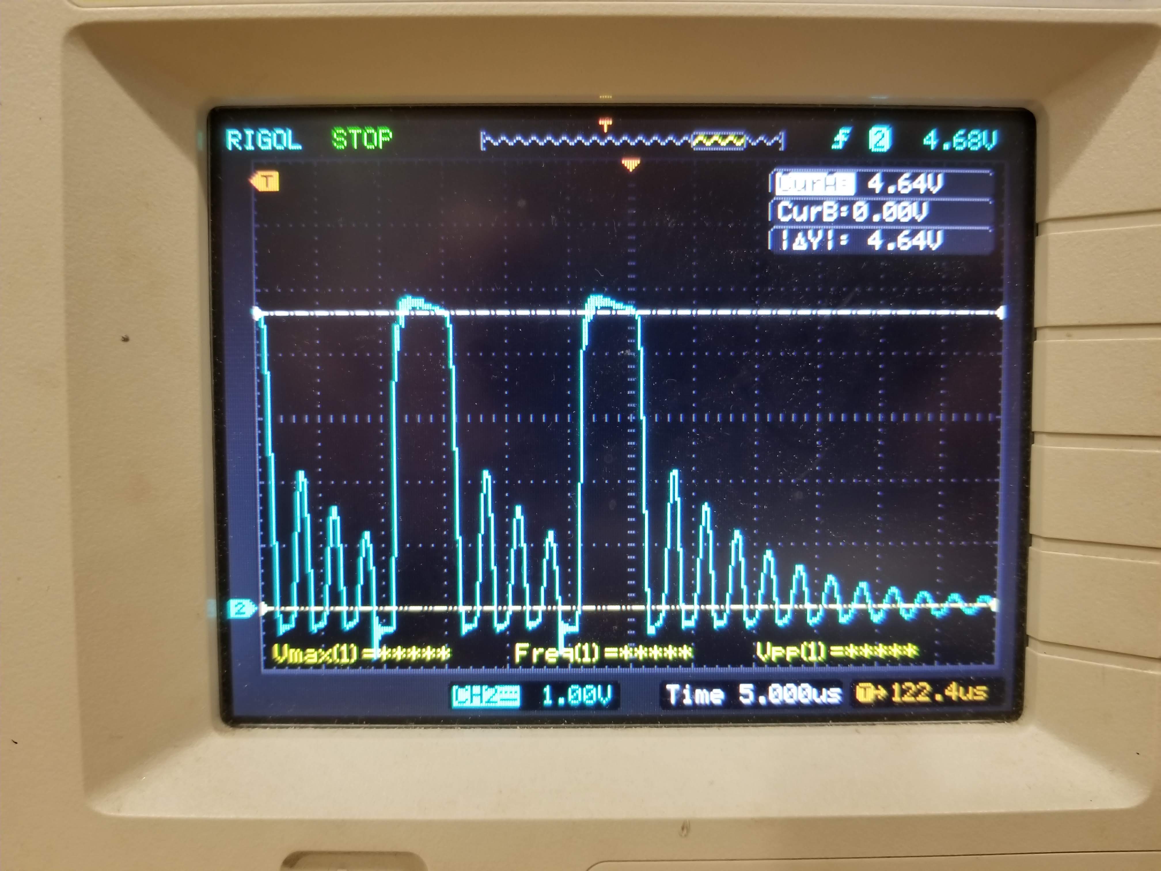

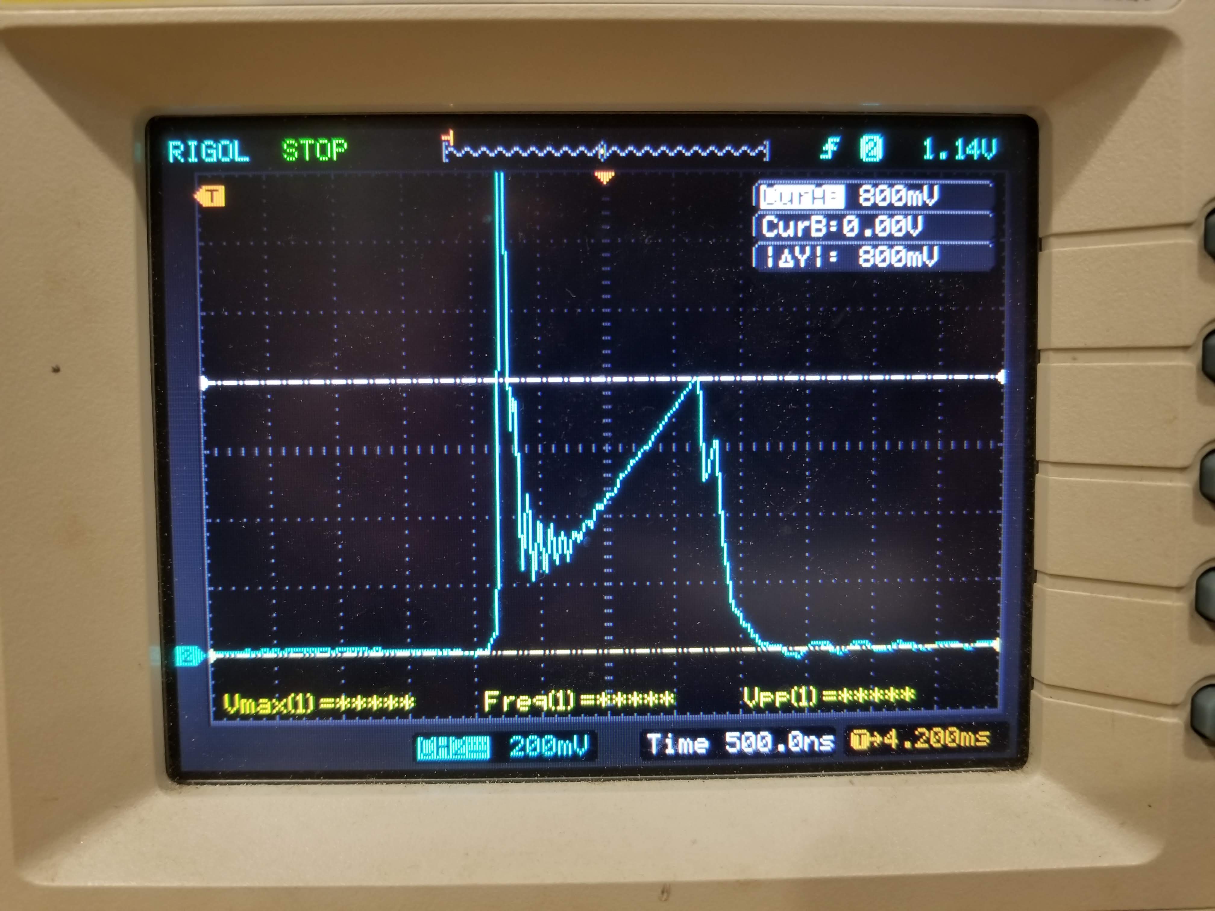

Pics of CS, VS and FB during the last cycle(s):
CH2:CS. VCS is above Vcst(max) on the last switching cycle.
CH2: VS. In the last two cycles, VS goes up to 4.6V.
CH2: FB.
If I change RCS and/or RLC to decrease VCS, it will still hit it. I tried with RCS=1.6ohm and RLC=3.3K (instead of 1.8 and 2k), VOUT goes up to 6V before stopping.

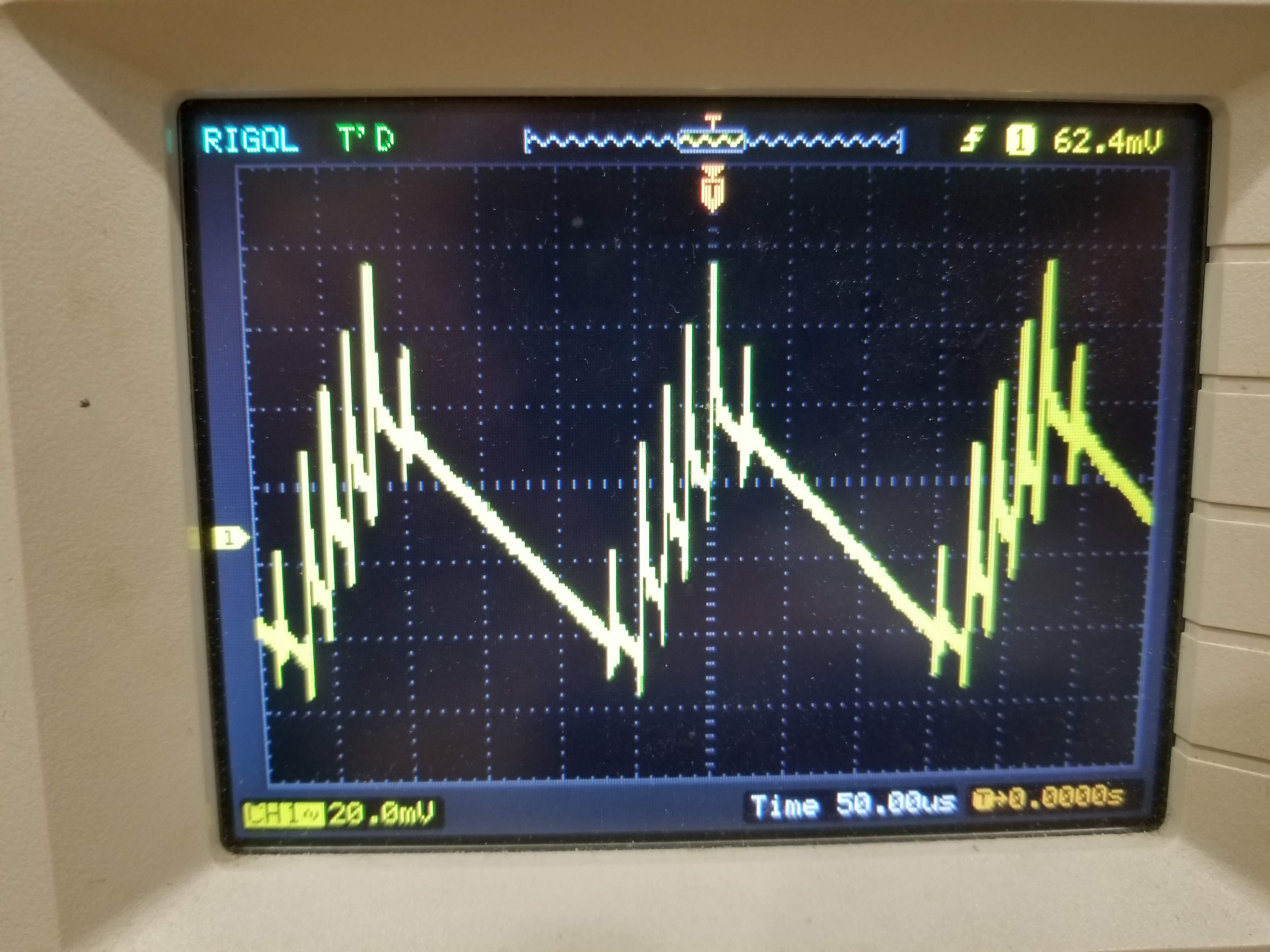

2)
In this case, the regulation (when measured RMS) is good, response under load satisfying.
However, the chip works in a kind of burst mode (that is not supposed to exist in this chip). Instead of modulating its frequency to account for load, it will switch at a fixed frequency (around 68 kHz, lower than the theoretical max switching frequency), get the output about 150mV above expected output voltage, then stop until the output goes maybe 200mV under expected output voltage.
The resulting ripple depends on the load, but the switching frequency is the same at no load up to 500mA (I did not test above).
CH1:VOUT. Period is 30us (66.67kHz) when switching. the down slope depends on load, and so does the overall ripple frequency.

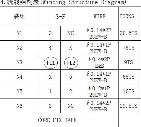

  • Case 1, can you please provide your transformer specs to see if the OVP is triggered? In the meantime, can you put C8 back but with 220nF value to see if the issue can be resolved? If not, with C8 = 220nF, change R5 to 51k, then test to see if the issue can be resolved.
    Case 2, can you specify the test conditions?
    Are case 1 and 2 from the same board - it seems not, and it seems case 1 on one board, and case 2 on the other board?

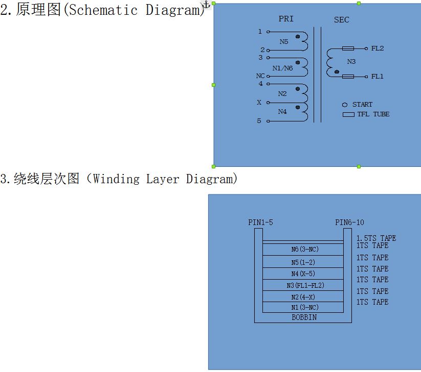

    Transformer specs are:
    Bobbin: EFD20 - not sure about the core used...
    Turns: PRI = 144, SEC = 9, AUX= 16
    NPS= 16
    NPA= 9
    Inductance of primary: measured at 0.98mH [ECH1062 AT60KHZ  1V] on the board sed for the pictures. Value is 1mH+-0.1 accross the 10 samples we received.
    N1/N6 connected to low potential of VBLK. Disconnecting it does not seems to affect the behavior.

  • Hi again,
    I'm happy to say that your suggestion (C8 = 220nF) seems to have solved my problem!
    I had a look with R5=51k but it works the same with the current value.
    The output looks normal (to me) now, switching frequency is again dependent on load, ripples are in an acceptable range for my application.
