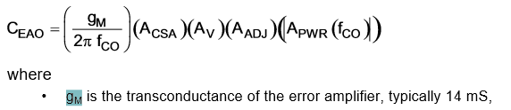

    Thanks for your reply, we'll look into performing that test, but I'd still like to see if we can get calculations that work out with the datasheet equations. Could you please clarify the following? (this is mostly about SLUS495I page 17)
    - there are two "gm" variables on that page, one "gM" in the Ceao equation that is referred to as the transconductance gain of the error amp, and another "gm" that's all lowercase and could refer to the gain margin of the system as defined in section 8.2.1. Can you confirm whether the transconductance gain should be used in both instances?
    - equation (11) seems wrong and we've found example calculations where Aadj is calculated as Radj x Rsense / (500 x (Radj + Rsense)). Is the datasheet version correct?
    - if an imaginary value was to be found for Reao, is the recommended approach to dither around the calculated value of Ceao until something works? What other things could we try?

  • Hi Kevin,
    On the subject of gM, I was referring to the one in eq 13, which has a different font, similar to the one in section 8.2.1.
    Parameters for our calculations:
    Rshunt = 0.5mohm
    Iout max = 40A
    Vout = 5.2V
    Radj = 22 ohms
    Igain = 200
    fco = 500 Hz (simulated converter bandwidth of 24kHz)
    Apwrfco = 300
    Rsense = 1k
    Sam
  • Hello  Sam,
    If I may respond to your original question which was addressed to me.
    There is an error in the SLUS495I data sheet.
    Equation 11 in the SLUS495I and the prior revision SLUS495H are different
    T
    he above equation is taken from Rev H data sheet
    And the equation below is taken from Rev I data sheet.
    I am attaching Rev H data sheet for reference.
    Can you please use the equations in Rev H and let me know how you get on ?
    I apologise for this and the data sheet will be corrected.
    Also "g suffix M" and "g non-suffix M" are the same parameter. This also is a datasheet error.
    Thank you for finding this and sorry for the inconvenience.
