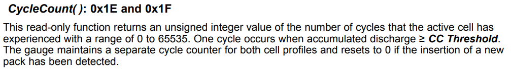

I am facing challenge with respect to cycle count.Module says that cycle count will be reset once new battery is inserted but it is not happening so we are manually trying to reset cycle count. but as Ti module says that gauge maintains separate cycle counter for both cell profiles. so to reset it which profile i should reset.
Is it something like i have to reset both the profiles? how will i know which profile is active(cyclecount 0 OR cyclecount 1).Can someone explain that how cycle count memory is mapped with respect to 2 cell profiles.

    1. In the module TRM it is mentioned that cycle count will be reset once new battery is inserted. But in my case the cycle count is not resetting. Can you help us to understand why this change in behavior?
    2.If we use the standard command for reading the cycle count from which location (cycle count 1 or cycle count 0) it is reading the data?
    Likhitha
  • I believe if the gauge uses the default profile instead of one of the two other profiles, then that is when the cycle count will be reset. The default profile is used if the gauge detects the batteries are brand new. See the TRM for details on how the gauge determines which profile to use.
    The command will return the count of which ever profile is being used by the gauge at that point.

    1.) I tried second method by checking Ra flag  but I am little bit confused regarding the values. as data sheet says default value will be 0x55 for Ra flag. In my case when cycle count 1 profile is active Ra 1 flag value is 0x00 and Ra0 is 0x55. Can i assume that whichever profile is active Ra flag will be 0x00?
    2) inserting a brand new battery also not resetting the cycle count.it is taking last used profile only. I have experimented with some 4 batteries and observed the cycle count profile used and found that it is always using pack 1 profile. data sheet is telling like profile will be used based on impedance matching but if i am inserting a brand new battery then also why the same profile is getting used(pack1). according to me it should be pack 0. since I have to reset the cycle count manually will it be safe and ok to reset the both cycle count? or we should only reset the active one. what will be the impact if i reset both?

  • 1. 00 for flag and 55 for status means it is the active one
    2. cycle count is for informative purposes and doesn't affect anything, so you can reset it manually
