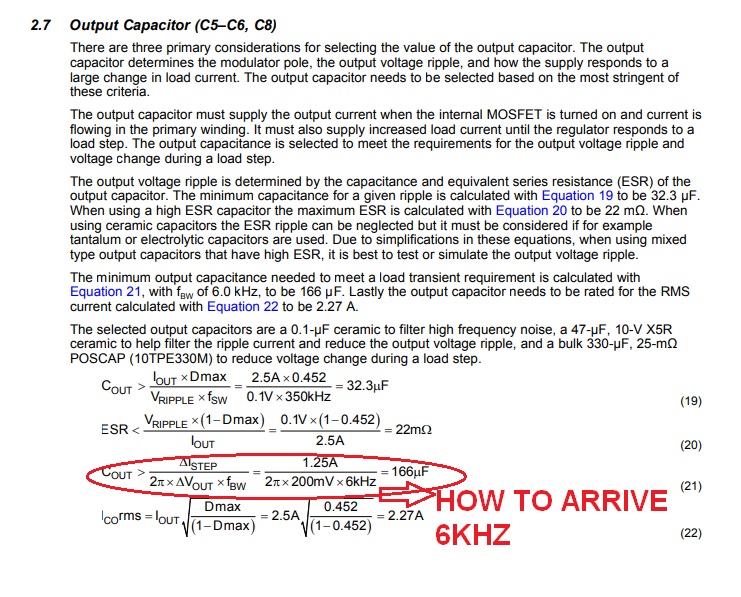

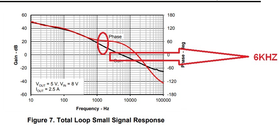

Thank you for your interests. The 6kHz is the loop bandwidth (see Figure 7 of the document), and the step load response should recover in about 1/6kHz time window. and before it is recovered the output capacitor should supply the additional current of the step. By satisfying (21) the output capacitor will maintain the output voltage from dipping below 200mV.
