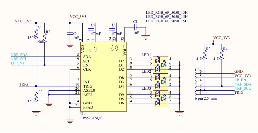

Hi there,
I am developing an RGB LED Driver circuit as shown below. Although I am expecting each LED to drain 20mA, the first LED drains 160mA where each additional LED drai 20mA more.
On the other hand, when I test the following breakout board, all looks fine, each LED drain 20mA as expected.
www.sparkfun.com/.../13884
Could you please let me know if I am doing something wrong?
