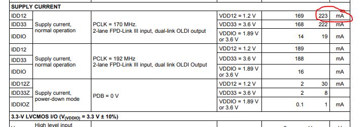

Will use 1 lane coax type for DS90UB948-Q1, LP5907 is cheaper, but is it suitable and the current enough?
  • Hi ,
    Yes it is possible to use LP5907-Q1 to supply the 1.2 V rail; however, you will want to consider the thermal performance depending on how much load current will be needed and how much headroom (Vin - Vout) you will have in your application.  From the DS90UB948-Q1 datasheet it looks like the 250 mA rating for LP5907-Q1 does satisfy the maximum current specification of IDD12.
