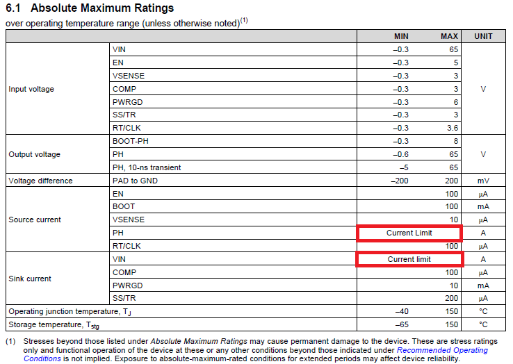

Hi Tim-san,
Thank you for your kind support.
I would just like to know inrush current of start-up is possible to damage TPS54260 or not.
I believe current limit can protect TPS54260 itself however would like to confirm just in case.
Yaita
Hi Ambreesh-san,
Thank you for your reply.
I would like to ask about Absolute maximum Ratings.
The following shows "Current limit" for Source current of PH and Sink current of VIN.
I believe these indicate internally protected by current limit feature in terms of Absolute Maximum Ratings.
Is my understanding correct?
