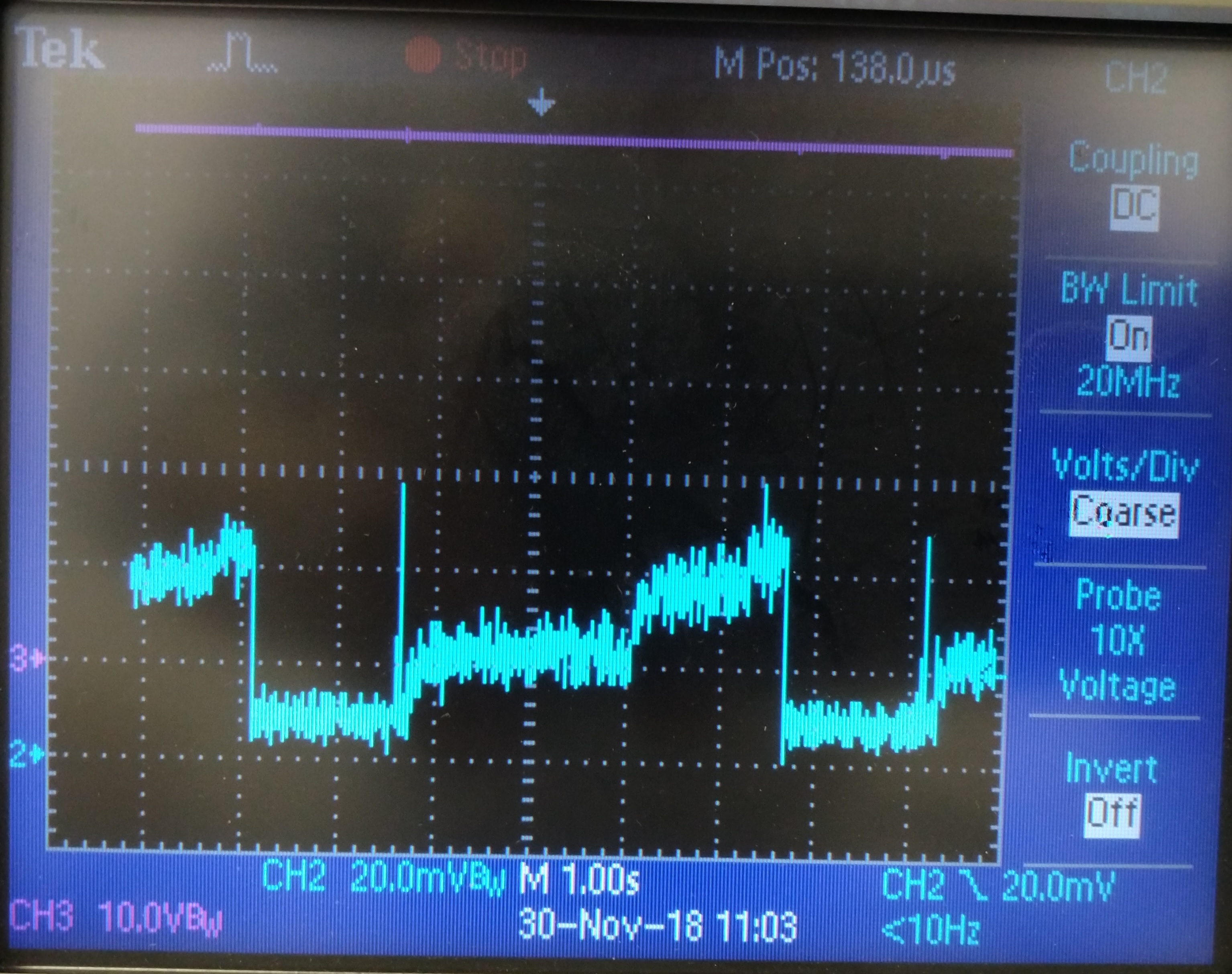

    As for the current, I have two test cases:
    1) the load is always 54.1V/34mA, the PSE is working, there is no power cycling.
    2) the load is 54.1V/34mA at the very beginning, then the CPU in load will turn on some components in it, so the current will go from 34mA to like 85mA, then I got the power cycling.
       The board is keeping power on/off, so the current is not stable, it could be any value between 0mA - 85mA, I measured more than 10 times, 85mA is the maximum I could get.

    Please refer to below for waveform. it's the voltage over two 0.51ohm resistors.

  • Hi Chris,
    I think my original suspect is right. Just to clarify,for the first test case, is the 34mA a stable DC current?
    For the second test case, the current is pulsing  and looks like the current doesn't meet the MPS spec in IEEE standard(The MPS is an electrical signature presented by the PD to assure the PSE that it is still present after operating voltage is applied. A valid MPS consists of a minimum dc current of 10 mA (or a 10-mA pulsed current for at least 75 ms every 325 ms) and an AC impedance lower than 26.3 kΩ in parallel with 0.05 μF). As TPS23861 uses DC disconnect, the load should meet the DC current requirement for MPS. To quickly verify this, you can do one more tests:
    1. Add some dummy load to your board and keep the current highter than 10mA and see if the PSE port keeps on.
    2. Disable DC disconnect in register 0x13 and rerun your second test case again and see if the port keeps on.
    Overall, the PD load didn't provide the valid MPS signal to keep the port on and the TPS23861's behavior is expected. Thanks.

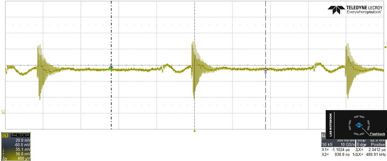

  • Hi Penny,
    I measured the current of sense resistor using both oscilloscope and multi-meter, there is no chance its voltage will be less than 2.55mV, the minimum value of my board is like 21mV.
    In my board, I am using a boost circuit to generate 54V from 12V, so there is some noise in the waveform of R sense, please refer to below for details, will this noise cause the problem?
    Chris
