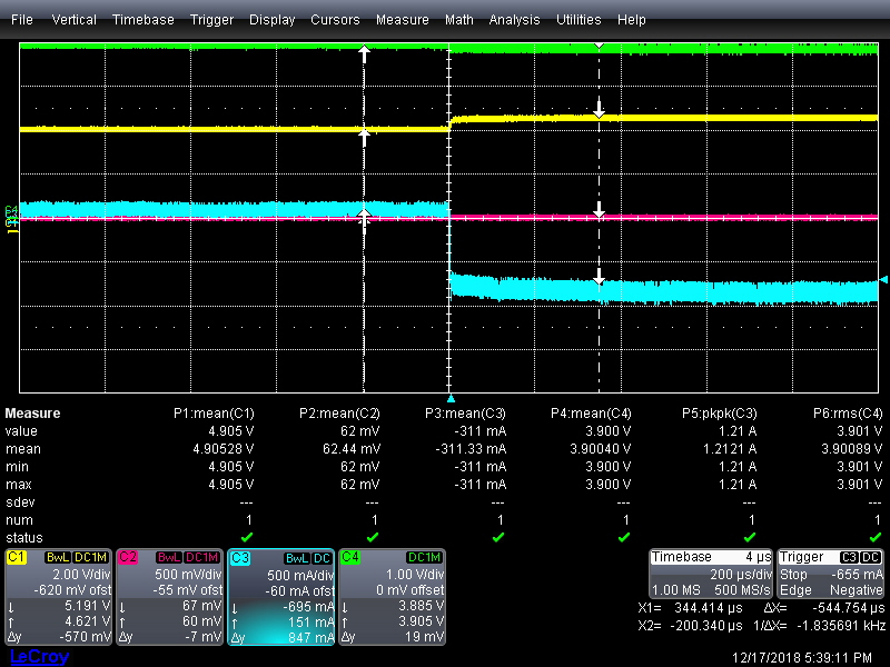

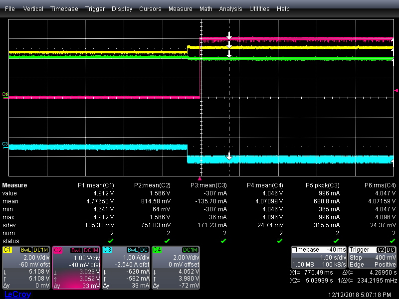

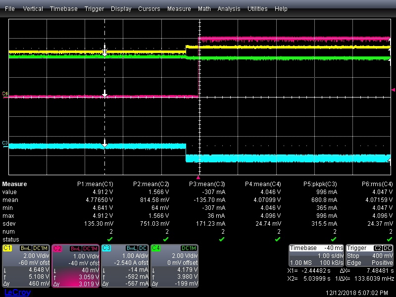

  • Dear Joel:
    Get the scope with below signal:
    PIO3 is our trigger signal as the CHRG_STAT(REG08) change  to 00(Not charging) from 10(Fast Charging) .
    Yellow curve: VBUS
    pink curve: PIO3
    blue curve: current of battery
    green curve: voltage of battery
    We also capture I2C data with Acute Logic Analyzer .
    The file with .law, you can download related LA viewer tool from Acute web. I also export the I2C data to I2C_TimerExp_20181212.csv. (The attached file LA data.rar)

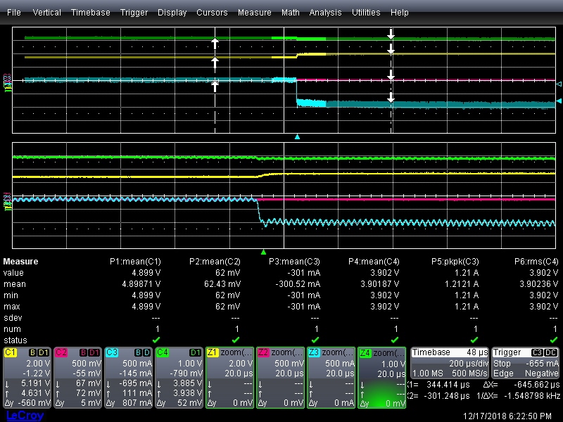

  • Hey Miya,
    You are going to hate me, but I need to see a more zoomed in waveform of this event. Right now you have it as 1s/div which is way too long to capture a transient like the one I'm looking for. Trying 10ms/div to 100ms/div. For PIO3, how far between in time are the register reads? Is your excerpt of the datalog in sec, ms, us? I am trying to get a feel for where on this waveform each successive sample of the charger data is being taken.
    Joel H

  • Hey Miya,
    I am not familiar with the software you recommended but from what I can tell, the data only goes back ~500ms from your trigger point. And then it immediately jumps to your trigger point at around time zero.
    This is why we need trigger on the battery current falling edge zoomed in time. I suspect some other event is occurring when this transition is happening.
    Joel H
  • Hey Miya,
    To add to my previous reply, I also saw the waveforms in your most recent captures, but I need to ask if these are just zoomed of the previous ones or are they taken at the new time scale? I ask because there is a small spike in the battery voltage that I want to analyze in conjunction with the VBUS waveform.
    I think we need to see something more zoomed in, about 100 us time frame just to be sure.
    Joel H

  • Hey Miya,
    Yes, I'm just concerned when the charge current goes to zero, that sudden transient step is forcing another fault or some POR condition meaning that in between reads, the device is reset. I good way to check this is to see whether the settings you programmed on the charger before the timer expires match the settings after.
    My point about the log sampling rate is that the transient event can be much faster than 500ms and trigger a device reset.
    I wanted to look at a very zoomed in waveform (100us is an estimate now, maybe even shorter) to see if VBUS, VBAT, or both drop too low after this event.
    Joel H
  • Dear Joel:
    We read back the REG_04 after the issue occurred, and thee register value is same with our settings - 0xCB.
    The charging IC seems not reset. The default value of REG_04 in charger IC is 0xB2 not 0xCB.
    We get the SCOPE with 200us/div and trigger with charger current. Triggered with charger current. PIO3 does not connect.
    The related wave file.
    200us_wave_20181217.rar
  • Hey Miya,
    Your waveform looks fine. There is nothing to suggest the charger going into an OVP/ULVO condition on either VBAT or VBUS.
    I will run a similar test on the BQ24295EVM and get back to you. We know the charge safety timer expiration trigger a fault.
    Joel H
