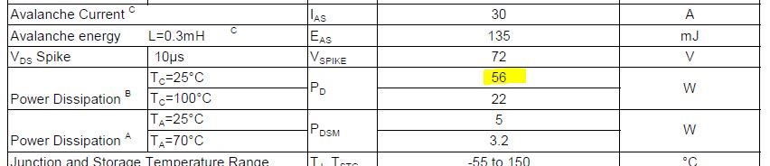

We know the PWR pin set the Plimit, does it means the FET peak PD should be less than the setting value?
  • Hi Johnny,
    Welcome to E2E!
    The Plim setting is time bound value where as PD in the FET datasheet is steady state power dissipation at a particular case temperature. You have to use SOA curves in the MOSFET datasheet. Please look at the videos in the design calculator and let me know if you have any questions.
