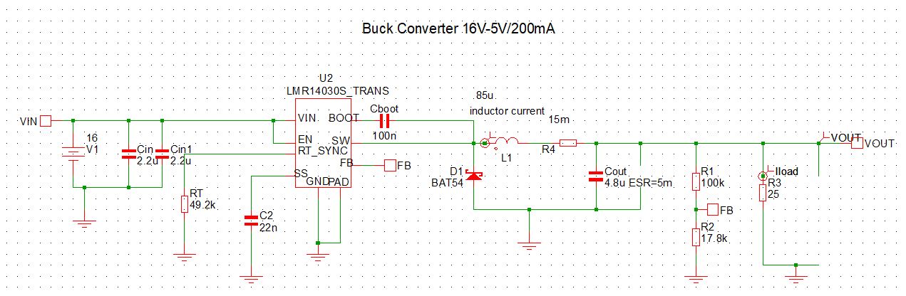

My input specifications are.
1. Generate a 5V +/- 3% output voltage ; output ripple~50mV or less if deemed necessary
2. Nominal operating range 9-16V
3. Output current ~200mA

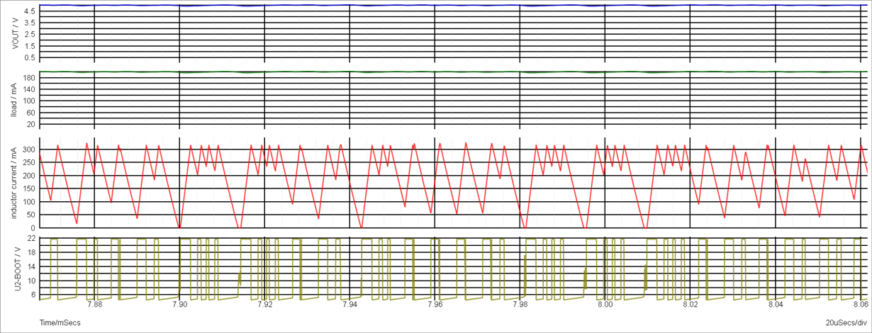

4. Switching frequency: Around 500 kHz – you can increase the Fsw up to~2MHz if the components needed for lower Fsw are too big.
For the above requirement i designed the inductor and capacitor values as 85uh and 4.7uf.But with these values i am not getting the continous inductor current cylces.
