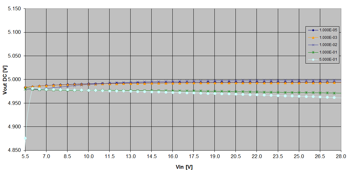

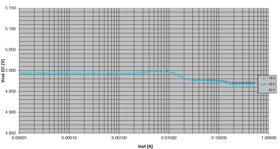

In the datasheet of the TPS62175 datasheet, we provided the Vout = 3.3V Load and Line Regulation data. Can you help to advise the corresponding data for Vout = 5V?
Thank you.
