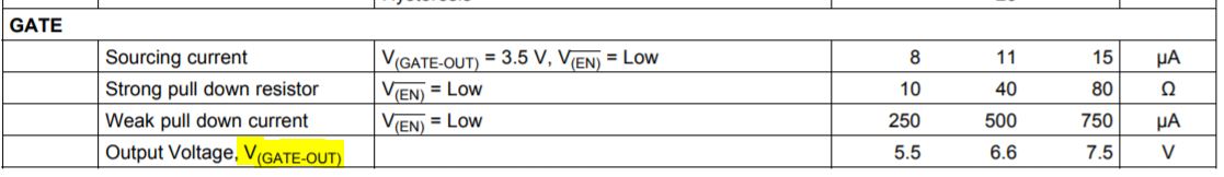

  • I do have another question regarding the GATE pin.  The datasheet says that the maximum voltage on GATE is 7.5V.   But this cannot be correct !  If this part uses an NMOS FET as its switch, its gate voltage would need to be greater than 20V to turn ON this FET if I undersatnd how FETS work.  Is my interpretation of this specification in error?
  • Hi Al Paulhus,
    Your understanding is correct. For N-Channel FET's , the Gate voltage has to be greater than the Source Voltage.
    As you can see in the Datasheet 'ELECTRICAL CHARACTERISTICS' section, the Gate Output Voltage is specified as 'GATE-OUT' voltage which is the gate to Source Voltage.
    If the Vin raises, the Gate Voltage also raises maintaining V(GATE-OUT) around 6.6V.
