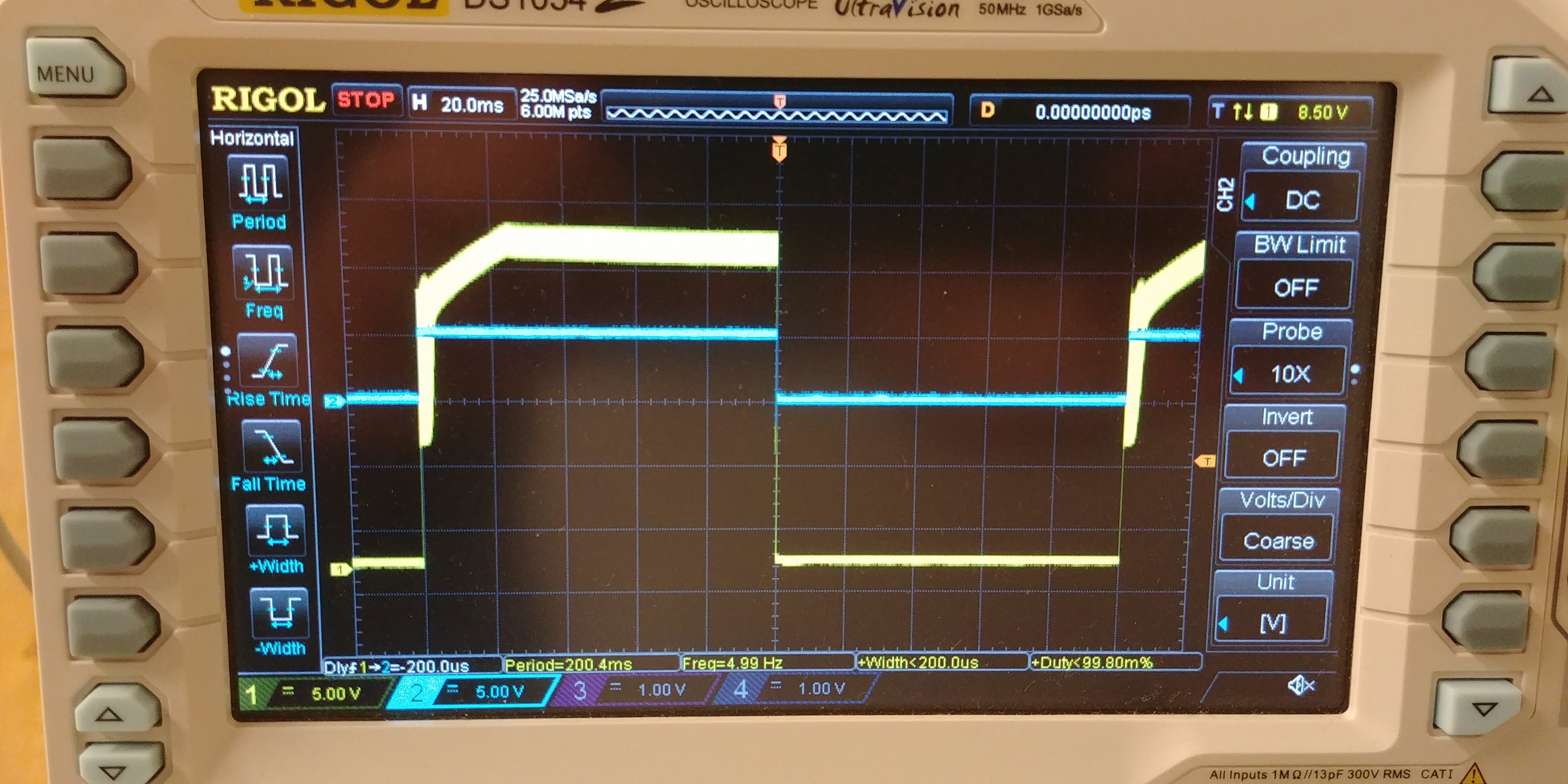

I'm trying to do short pulses using LM3409HV evaluation board and I'm getting high rise time when I use EN pin PWM (low frequency)
PWM: 5-100ms
Freq: 20-60Hz
Duty cycle: 10-50%
Setup:
Power supply - 36V
7 LED's SFH4780s in series
I also tried using PWM2 and I'm getting results according to spec - there is only a humming sound
Please assist, using EN pin is much easier for my setup
Michael

  • Hi Irwin,
    Using PWM2 the dimming is working according to spec.
    * J1 state is open (no jumper) when I use EN pin PWM (according to datasheet)
    * I use external 5V power source with optocoupler and pulldown resistor on EN pin (the blue line on the picture is the EN pin)
    * Didn't look on the power supply line - I can check but it works with PWM2 so I don't think its the problem . Measured the Vin, its steady, no drops
    * I use 220-36V, 4A DC power supply and I connect the EVM with banana jack (50cm wires)
    * I will take a look on VCC - Vcc is same as Vin when EN is grounded
    ***update***
    at 40Hz (50% duty cycle) PWM on EN the the issue is resolved, there is a clean signal.
    But the system has to work at 20-60Hz

  • Hello Michael,
    Vcc cannot be the same as Vin, Vcc should be 6V. In low power shut-down the VCC will drop. From the datasheet:
    "8.4.1 Low-Power Shutdown
    The LM3409/09HV can be placed into a low-power shutdown (typically 110 μA) by grounding the EN terminal
    (any voltage below 0.5 V) until VCC drops below the VCC UVLO threshold (typically 3.73 V). During normal
    operation this terminal should be tied to a voltage above 1.74 V and below absolute maximum input voltage
    rating."
    If Vcc is dropping and going into low power perhaps a large VCC capacitor will allow a longer PWM low time.
  • Hi Irwin,
    I measured Vcc relative to ground, going over the datasheet the Vcc is referenced to Vin so I do get 0v when EN is low and around 6V when EN is high.
    I also saw that the rise time is effected by OFF time, when OFF time is lower than 10ms the rise time is OK.
    I read on the forum the the sleep time of EN is 10ms, and its explain the high rise time.
    I'll try to add larger Vcc capacitor, also I read that I can use UVLO to do PWM - how do I do it?
    Yes, Vcc on the high side, sorry about that confusion.  UVLO can be used for PWM as well.  If you are using UVLO you can just pull the UVLO pin low for disabling and release it when PWM is high.  This can be done with a diode to the UVLO pin or a transistor/FET pulling the node low.
