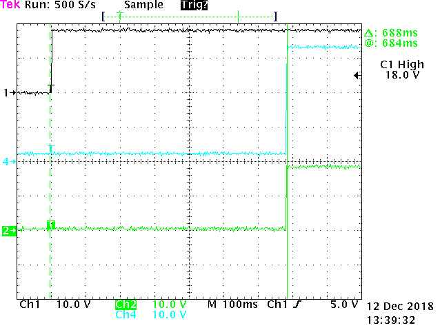

LM5069: LM5069 My issue is power adapters can spark when plugged in due to inrush current
Part Number: LM5069
Dear,
our client use LM5069, but we find the some issue, power adapters can spark when plugged in due to inrush current, so we need confirm schematic and calculator tool.
PS-1, in schematics, now the U32=NI and R831=0.
PS-2, Tried change C317=4.7uf but no help.
mx310hd-v03-13.pdf
and attached is our Design Calculator file. (ps, step-3 and step-4 more items don’t know what is it, so attached MOSFET datasheet
LM5069_Design_Calculator_REV_C-Jeff.xlsx
If any suggestion, Please advise me.
