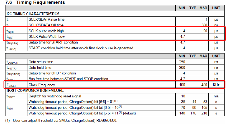

Regarding 7.6 Timing Requirements
(1) Test Condition of tR
Could you please let me know test condition of rise time and fall time (reference voltage).
Should it be measured (VIN_LO=0.4V), (VIN_HI=1.3V) regardless of the supply voltage to the bus or device?
(2) Timing Spec of the tWH
Maximum Clock Frequency is specified 400kHz.
Even if I use minimum value of twH and twL, minimum period is calculated 8.7us.
This means maximum clock is 114kHz.
Which is correct?
