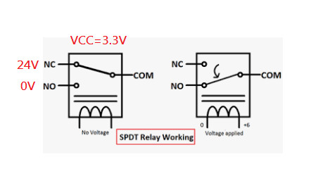

Hi E2E,
Do you have analog switch which has function as below?
Thanks!
  • Julian,
    We do not have have a device that can support 24V and Vcc = 3.3V at the same time. We have devices like the TMUX6119 that will support 24V but they will require a 24V supply.
    Why do you need to support 24V with a 3.3V supply?
    Thank you,
    Adam
