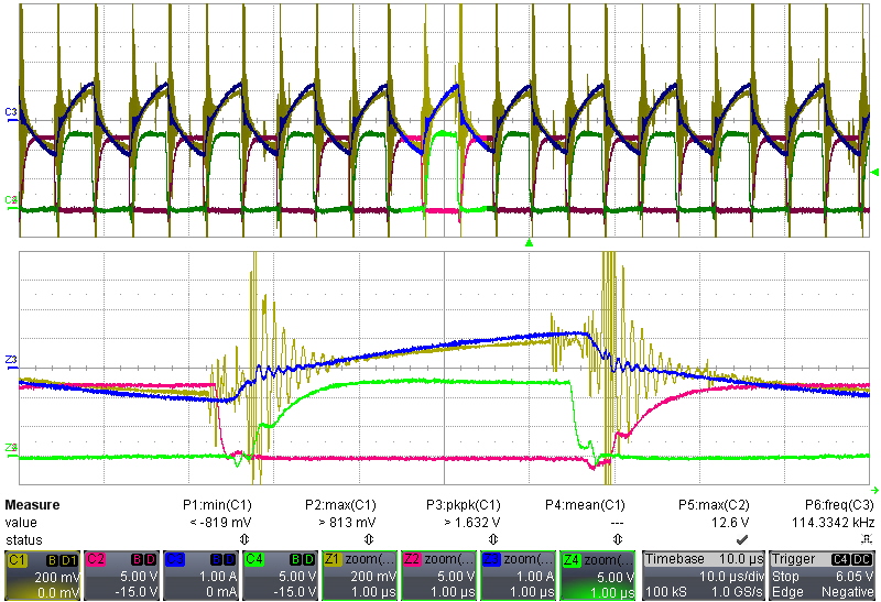

Dear
When I use the IC UCC25630-3, it happens to shut down in the unprotection.
IC'S GATE DRIVER stops working & Latching off.
Why was it happened?
Could you reply my question,please?
THX

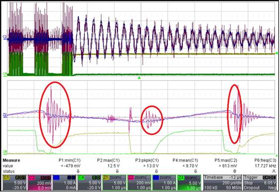

  • Our observation is that the red circled areas show ISNS has multiple zero crossings and likely the issue in your design of LO latch up is due to these ISNS multiple zero crossings.
    These noises need to be attenuated so to eliminate the multiple zero crossings to make the IC operation normally.
    We are still reviewing your design layout and will reply to you after review.

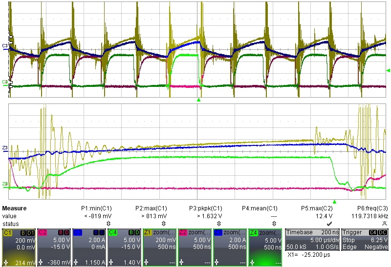

  • The waveform was captured on unlatch case.
    You can watch waveform which there are the multiple zero crossings.
    Can you explain why it don't shut down?
    CH1 Isns
    CH2 LOW
    CH3 Cr Voltage
    CH4 HIGH
    CH1 Isns
    CH2 LOW
    CH3 Resonant current
    CH4 HIGH
  • Our analysis and test show if there are no multiple zero crossings, there will be no LO latch-up due to the multiple zero crossing; but if there are multiple zero crossings, it is likely there will be LO latch-up. That means, multiple zero crossings can cause LO latch-up but that is not to say multiple zero crossings must cause LO latch-up right with the present of multiple zero crossings. The multiple zero crossings cause the IC internal race conditions so LO latch-up can happen when external multiple zero crossings happened coincidentally have been winning the race conditions.
    So based on what we know, eliminating multiple zero crossings is the way to eliminate the LO latch-up due to the multiple zero crossings.

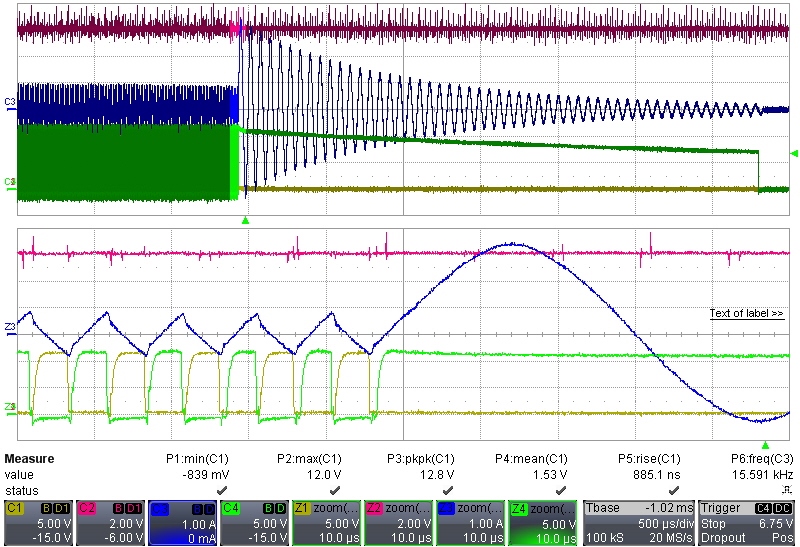

  • Latch waveform
    Like this you can explain the situation which LOW is off but High is on.
    CH1 LOW
    CH2 RVCC
    CH3 resonant current
    CH4 HIGH
  • Your previous waveforms always present multiple zero crossings. You need to show LO latch without multiple zero crossings so we can take it as a different issue.
  • You need to show ISNS waveform along with LO latch, and ISNS has no multiple zero crossings - then we can take it as a new issue. If ISNS shows multiple zero crossings, then it is not a new issue, and we answered your original questions.
