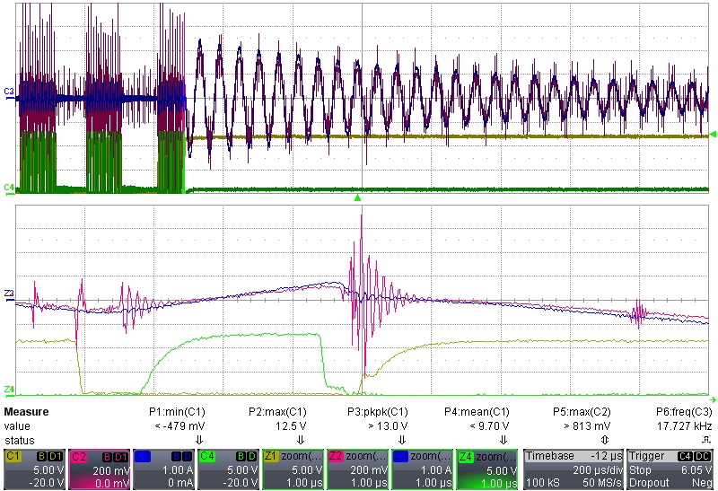

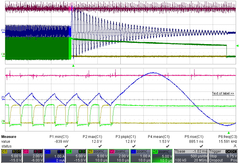

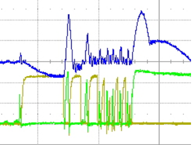

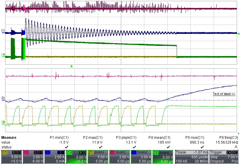

When I use the IC UCC25630-3, it happens to shut down in the unprotection.
IC'S GATE DRIVER stops working & Latching off.
Why was it happened?
Could you reply my question,please?
THX

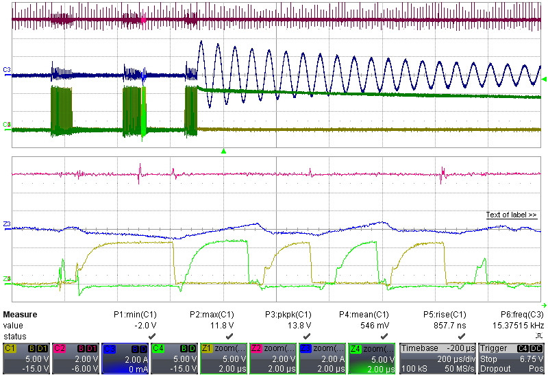

RVCC & VCC always hold on the same the voltage like above waveform.
I have double-checked the probem.
Driver suddenly stops working and never working again.
Unless VCC is under UVLO, It can work again.
You can try to use EVM at light load and shut down the IC .
You will see it.
Even if it rings, it still attain to OCP POINT.

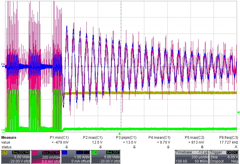

The waveform shows possibly RVCC is nearby UVLO OFF so turn off both drivers. RVCC off at typical 7V. Your waveform shows that from either driver output. The waveform still needs further zoom-in and with better resolution. Have you checked RVCC as I asked before? If RVCC ok, please find out why both drivers show around 7V or even < 7V?

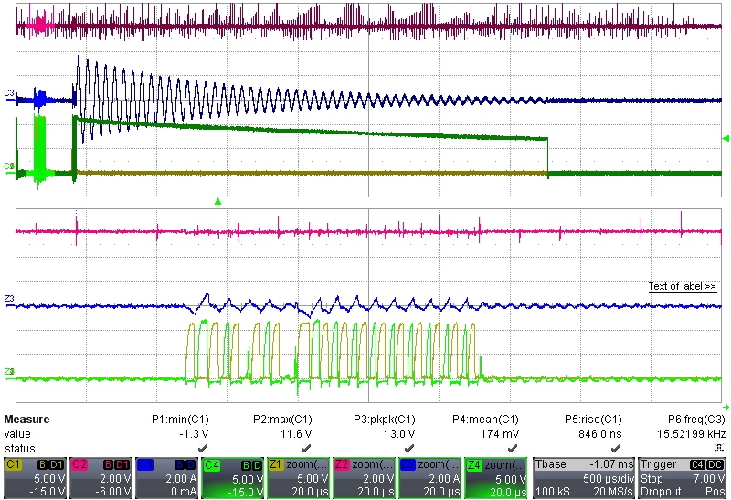

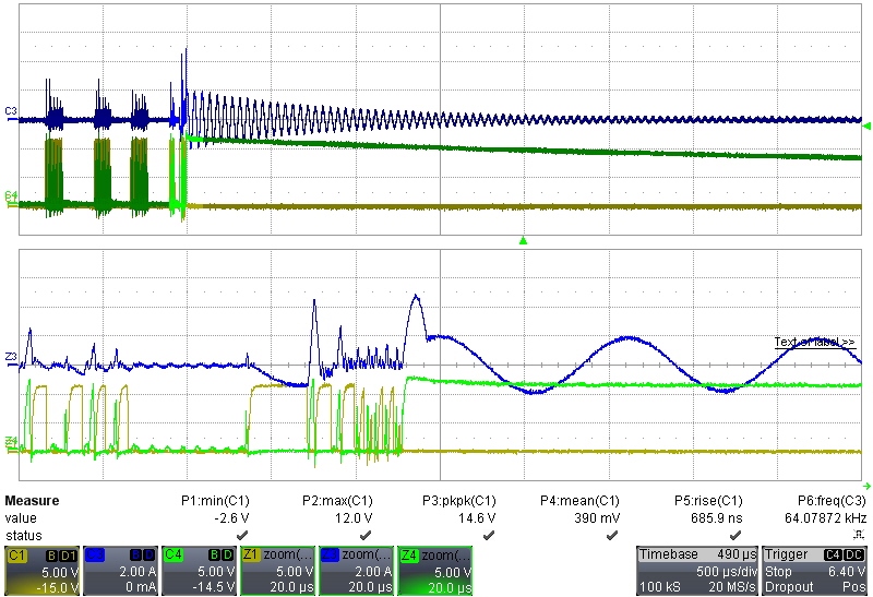

Please show RVCC together with both driver pulses at switching stop area, that is add RVCC into the below waveform you showed. Please also show better resolution for the waveform since the waveform shows both driver outputs are near 7V which is nearby RVCC UVLO OFF. Please use better time scale so we can tell what is RVCC and if RVCC is ok why both drivers outputs are at 7V nearby. Please provide these so we can see if any hints.

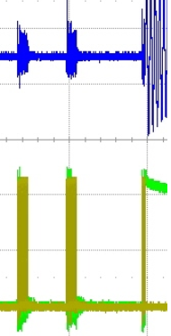

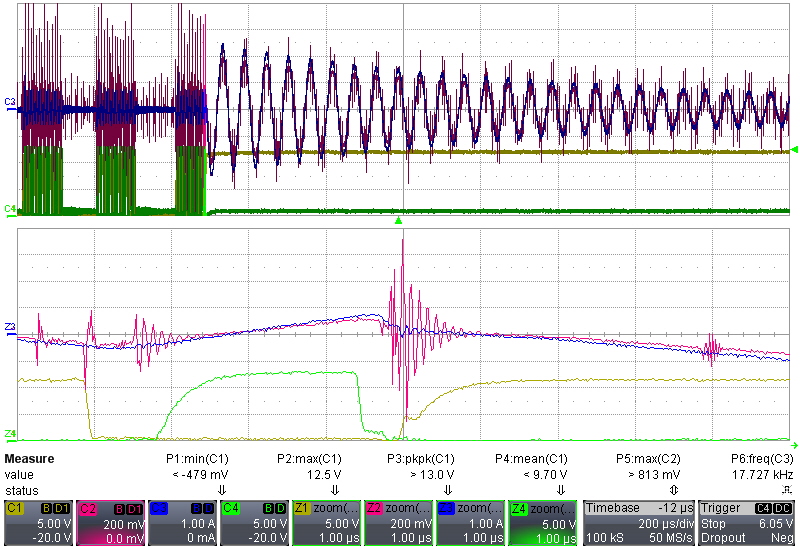

Please also zoom in the below which is copied from your 1ms/div scale. We need to see if the wide pulse is always there or just there before switching stops. It looks you can use 200us/div to re-capture the waveform. The purpose is to check if the wide pulse is always there - so if 100us/div cannot make it clear, please use use zoom-in to show. Please add RVCC to the waveform capture. We need to confirm RVCC ok.

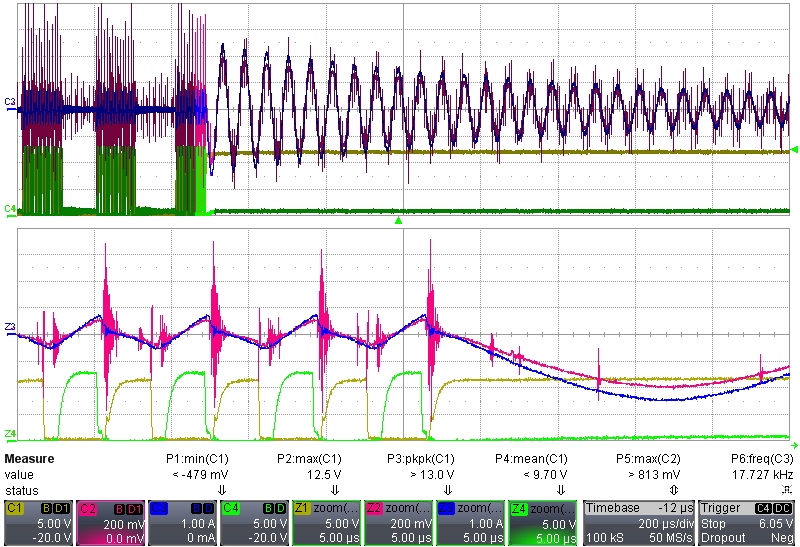

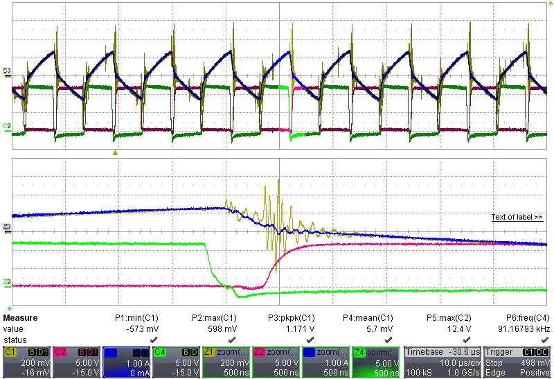

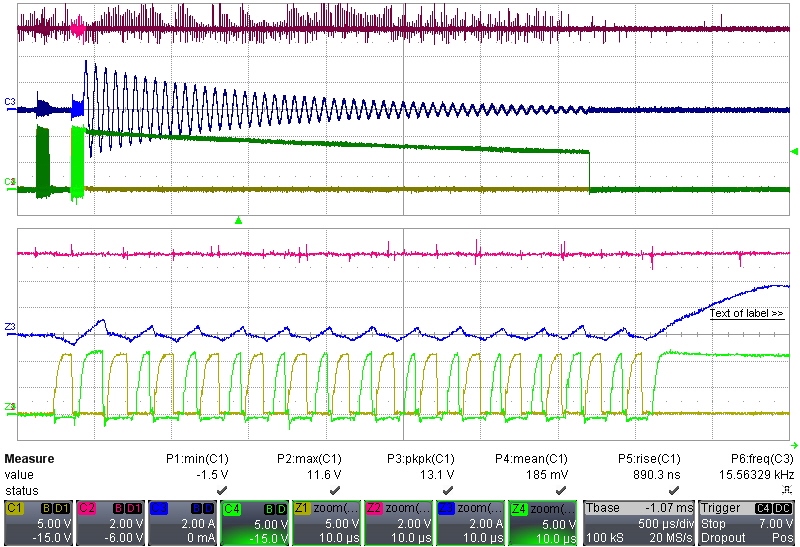

What's is different form two waveform?
It has latched off ,too.
Though it's not at 7V , it still stops working.
Can you give me any reason to explain the situation?
What do you mean that I don't understand?
I had provided you with waveform which you wanted timing.
Even if it wasn't consistent, it was latched off.
Can you clearly describe what you want?

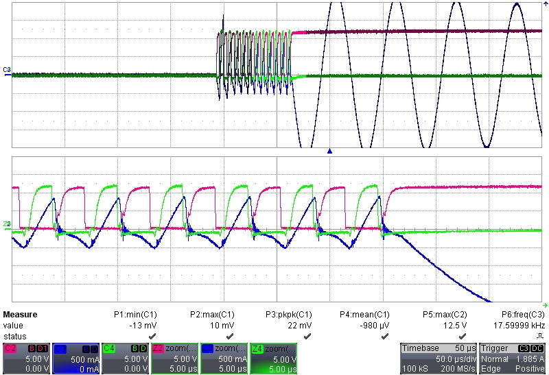

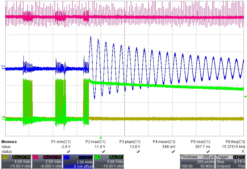

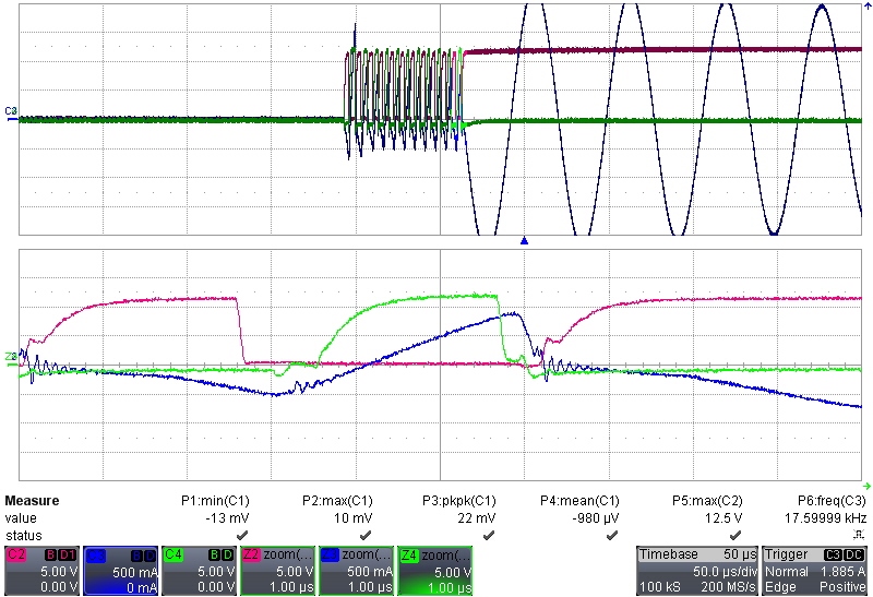

I can't capture the same waveform now.
But its condition is the same.
Don't focus on before waveform.
Can you use the last waveform to solve it?
It has being the same situation and I has checked that no protection was happened.
My problem is simple what it had been latched.
The Vcc isn't UVLO.
If you don't know the problem, can change anyone ?

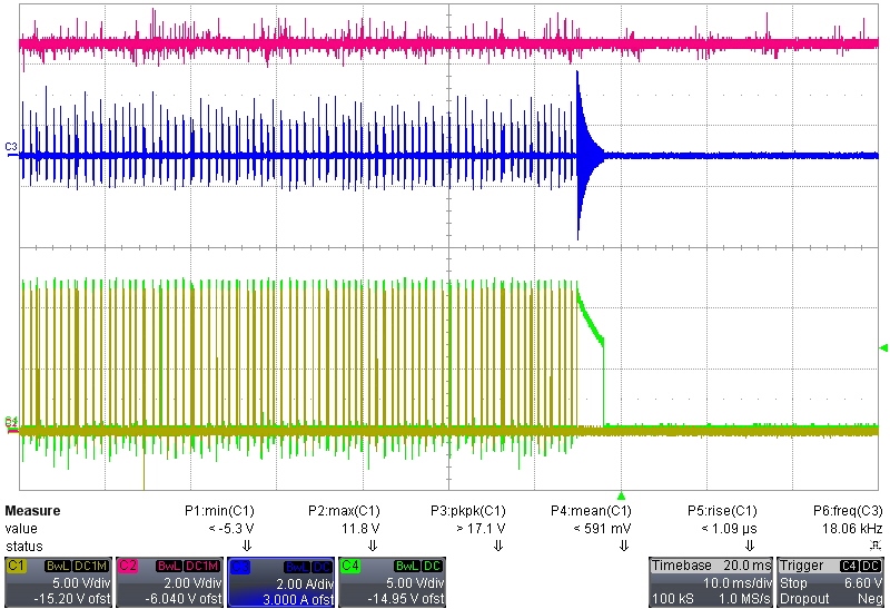

not at skip mode
It still stops working.

It's random, but it often happens at light load .
if it's not at skip mode, it sometimes happens.

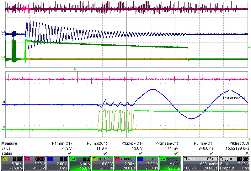

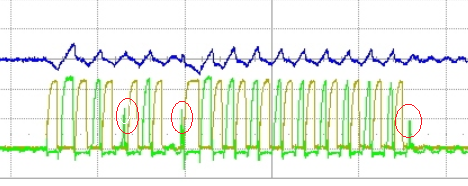

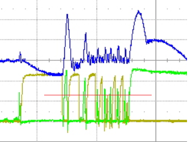

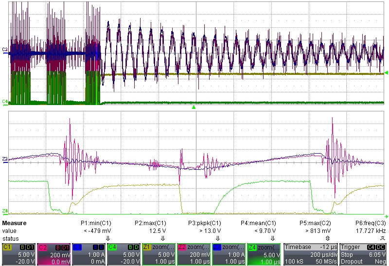

As these are confirmed, one possible reason we can think is ISNS pin signal gets multiple zero crossings which can confuse the internal function. Can you probe ISNS zero crossings along with LO/HO latch off? If you do see multiple zero crossings, you can try to increase C126 in your design (may also need increase a bit of C114) to eliminate the multiple zero crossings to see if the issues can be resolved.
I guess that you mean to increase the capacitance on Isne pin.
I had tried to increase the value of capacitance before you made the remark.
It can improve the situation, but it still sometimes happens.
If the value is too large, power won't start up.
I try to capture Isne waveform but it is plenty of noise on it.
I think that it may be have other problems in it.

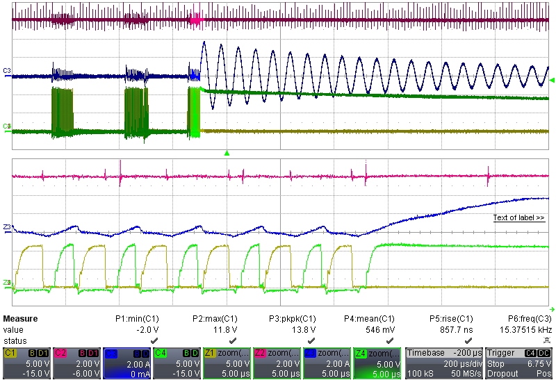

If increase capacitance cannot be sure to eliminate ISNS signal multiple zero crossings, the next that can be is to review the layout to see it can be improved. The ISNS should not have multiple zero crossings which needs to confirm.
Our layout is following the datasheet's suggestion.
Here we can get only two solutions which are checking datasheet and layout.
Can you give me another more better solution?

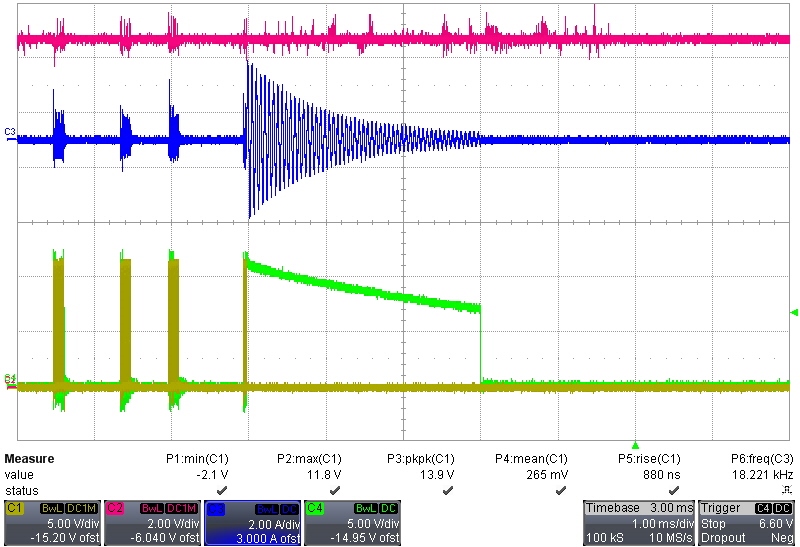

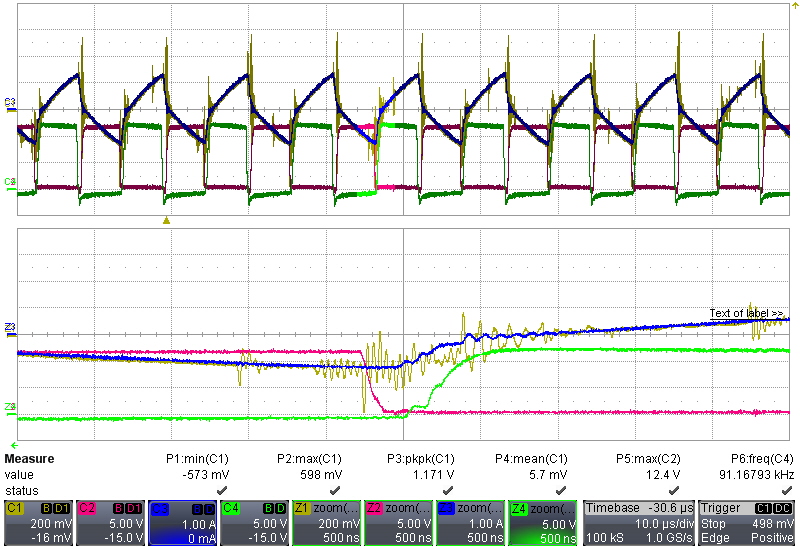

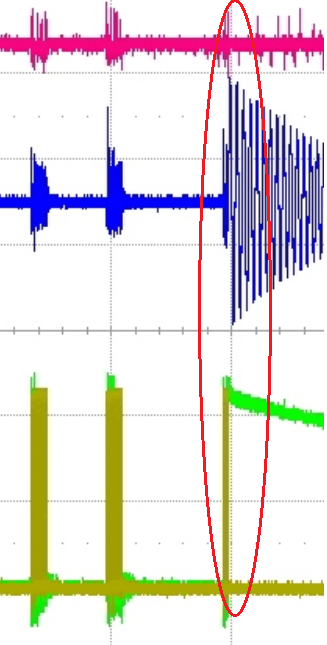

You said that latched situation was appear to result from multiple zero crossings.
But it isn't now.
What dose other problem be able to cause latch off ?
Zero Crossing should be used during died time.
The waveform can watch the section no zero crossing, but it is stopping work.
There is a PFC to supply steady 400V, and it works well.

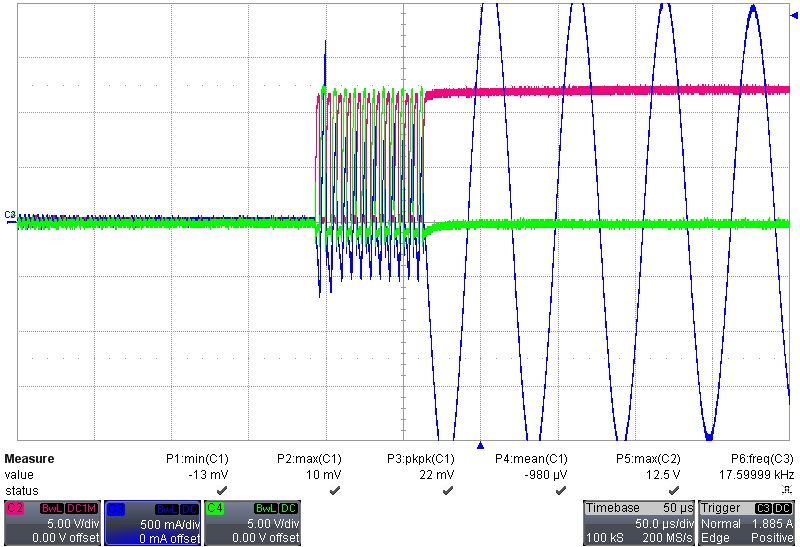

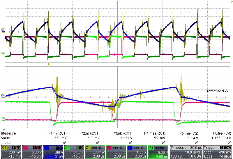

CH1 LOW
CH2 ISNS
CH3 RESONANT CURRENT
CH4 HIGH
