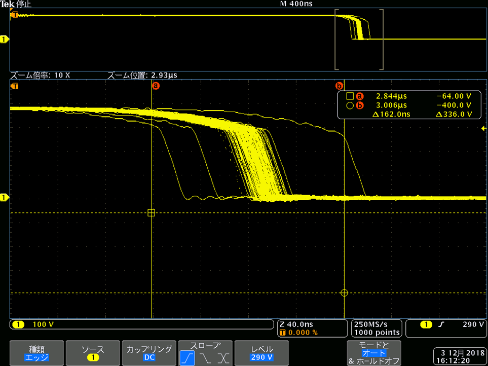

I have three points question below for UCC28950EVM-442;
①When measured voltage waveform near the transformer, attached below.
 It look a little gap:⊿t=162ns, is it normal operation?
②Component selection of D5 and D11.
 The other board(750Vin ⇒ 140Vout/10A) using 1000V/3A diode for reduce ringing, but troubling large power dissipation.
 I want to know way to good choice these diode.
③Is there layout guideline for Transformer?
 Customer will use PQ core transformer, they are worrying about bad influence for field magnetic.
 I want to know information about field magnetic and careful points on board.
※EVM external components is default setting.
Satoshi
  • Hello Satoshi
    1/ It's not unusual to see some jitter on the PWM signals. This can come from several sources the main ones being - if there is low frequency ripple on the input voltage to the power stage (2 x line frequency) then the control loop will adjust the duty cycle to maintain a constant output voltage.
    If there is some noise on the CS signal then the PWM period can be terminated early or late as the control loop compensates.
    2/ D5 and D11 are clamp diodes used to reduce voltage ringing on the secondary of the transformer. Normally they are chosen to carry the full output current and their voltage rating is the input voltage to the power stage plus some margin. They must be ultra fast types - SiC is a good choice.
    3/ We don't have a specific layout guideline for magnetics. A few points are worth mentioning. An external screen will reduce the amount of H field interference - grounding the external screen will also reduce the amount of E field noise. Keep the ends of the transformer windings on pins which are close together. If you are using flying leads to make the transformer connections then twist the leads together. This is to reduce the amount of H field interference from the currents in the windings and to a lesser extent to reduce the E field interference. Do not put any sensitive components under the transformer. Talk to the magnetics vendor about how to reduce the Common Mode and Differential mode noise generated by the transformer and about how to minimise the losses in the transformer windings. Some more information is at the TI Power Supply Design Seminars site at  http://www.ti.com/ww/en/power-training/login.shtml  and enter the keyword Magnetics.
