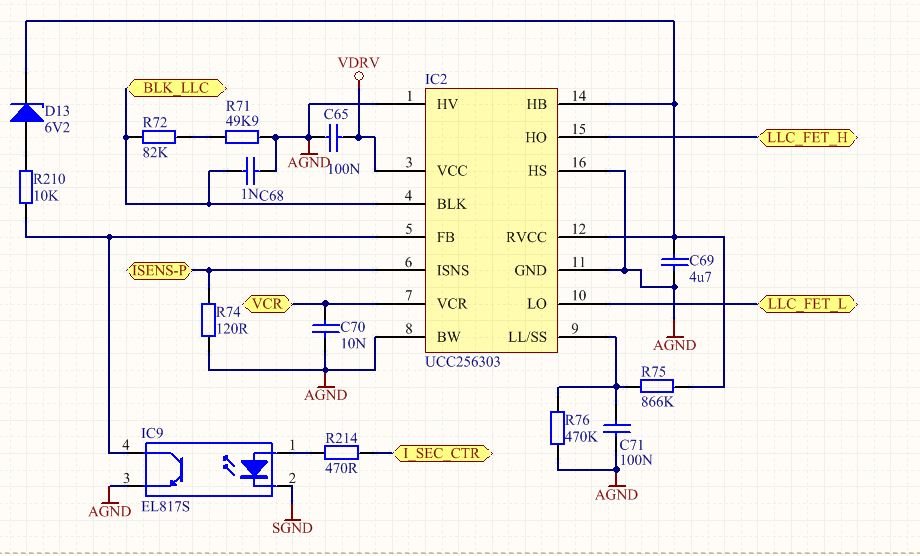

Dear Mike,
I found one issue which might be responsable for the problem I am facing. I have noticed that UCC256303 gets some information from the HS point i.e. adaptive dead time control. As per my schematic, HS is conected to ground since the UCC256303 doesn't drive the power MOSFETs directly but trough a dedicated HB Mosfet driver. (LLC_FET_H, LLC_FET_Low beeing the driver inputs)
Could the grounding of HS pin  be a problem?
