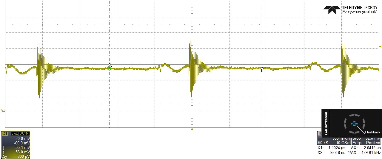

Hi experts,
I measured the voltage of two 0.51ohm resistors in parallel, the waveform is shown blow, will this be a problem?
In my board, I have to disable the  Disconnect Detection in 0x13h, otherwise the PD would be keeping power cycling. once I thought it might be caused by Maintain Power Signature, after measurement i found the minimum current of my board is like 80mA, which is much higher than 7.5mA.
By the way, the 54V is generated by a DC/DC switch, and the frequency is 500kHz.
Is there any other registers I should check?
Chris
  • Hi Chris,
    I would suggest to connect your load to TPS23861EVM-612 which will help you to isolate the problem. If TPS23861 can turn on the load without any power cycling issues, we will need to take a look at your schematic and layout. Thanks.
    Penny

  • Hi Chris,
    Have you tried with TPS23861EVM-612? Did you see the same behavior? Can you also send me waveform capturing RESET,VDD and VPWR in one screen and I want to check the power on sequence. Basically you need to follow the power on sequence described in this app note: http://www.ti.com/lit/an/slua818/slua818.pdf. Thanks.
    Penny
