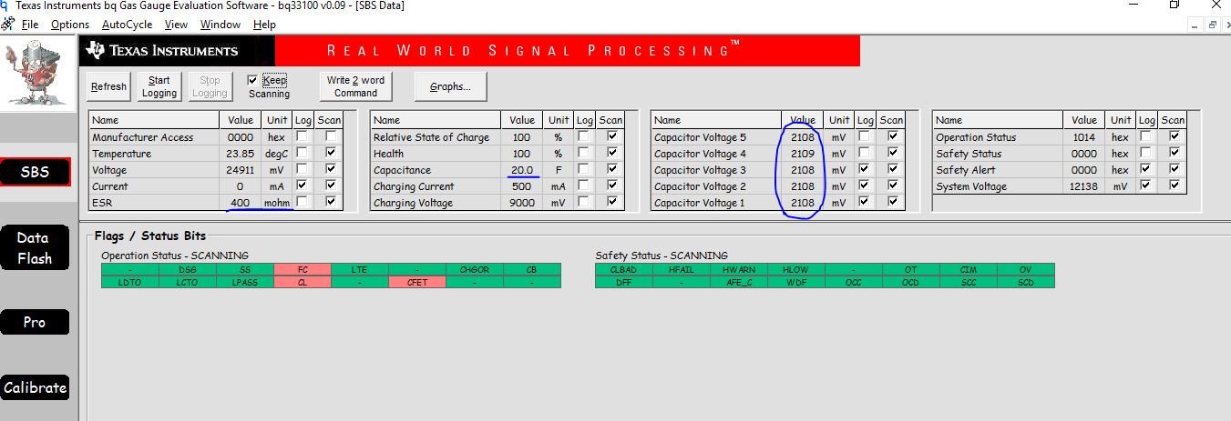

  • Thank you for your quick response.
    I have updated the data flash values.
    Can you tell me how to reset my STACK flag?

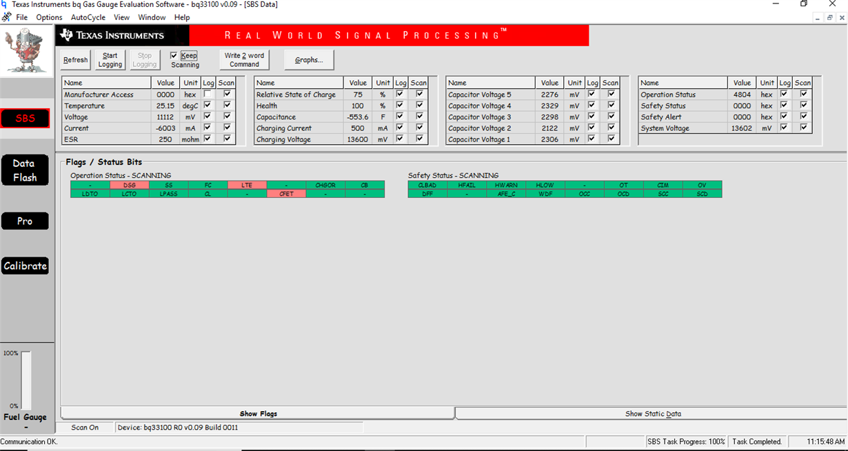

    I am attaching the screenshot of SBS command window so that you can help me to resolve the issue about capacitor and ESR value.
    Also, my five capacitor voltages don't match with the measured value.
    Please help me resolve these issue.
    Grishma

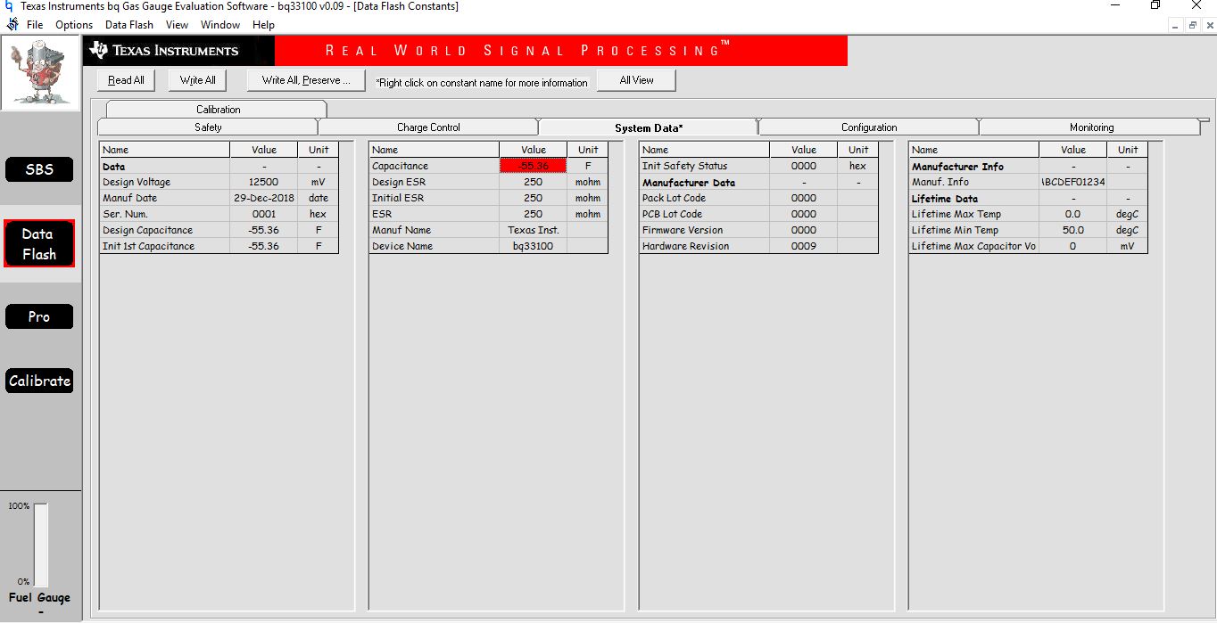

  • Is there anyone who can help me?
    I am attaching a screenshot of data flash window for your better understanding.

    I am trying to issue command 23 to start the capacitance learning cycle, but it's not updating.
     Also I cant not update capacitance value of 600F in data flash window. It showing the -55.35F.
    I think i am doing somthing wrong, Please help me to solve these issues.

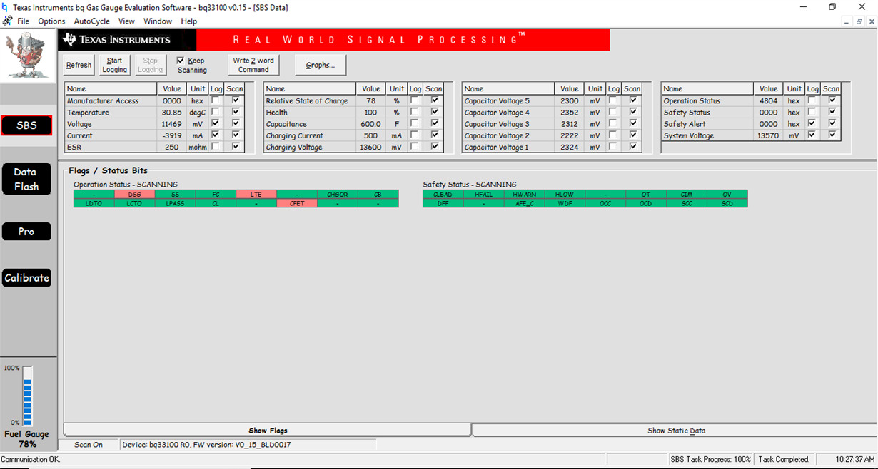

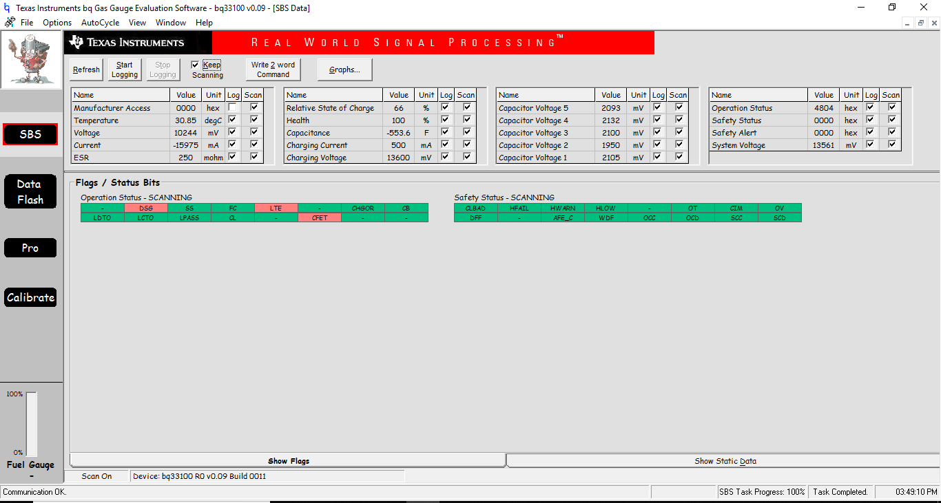

  • Hi Onyx,
    I have set the correct the initial value of my supercapacitor of 600F. But BQEVSW show -55.36F.
    No, LT_en flag does not set in the RAM.
    I am attaching the screenshot of SBS and data flash window along with gg file.
    Thank you,
    Grishma

  • Grishma
    You do not have any of the necessary flags enabled on your system. Your cfet flag is not set, neither is the LT_en flags set. pls program your device with the firmware in the link below:
    www.ti.com/.../sluc250
    then send the lifetime enable command 0x21 and ensure the fet is turned on by monitoring the flag cfet flag. If it isn't turned on, send command 0x46 to enable the fet.
    thanks
    Onyx
  • Onyx,
    As per your guidelines, I enable the cfet flag and LT_en flag by programming my device using firmware.
    But capacitance learning process did not started and my supercapacitor value is not updated. Its showing negative value of supercapacitor.
    Grishma
  • Did you start the learning cycle process by sending the learning cycle command?
    Are you running these tests on your evm or on your board? During learning, the gauge has to charge the cap voltage higher than the nominal charging voltage. pls reveiew all portions of the data sheep as this info will help you use the gauge.
    r.search.yahoo.com/.../RS=K44ZlxSBClH044sli8KUkb1MAGA-
    thanks
    Onyx
  • Yes, I started the learning cycle process by sending the learning cycle command. But BQEVSW didn't set [CL]=1.
    I am running these tests on Texas's bq33100EVM-001 board.
    I did the learning process as mentioned in datasheet. From recorded voltage and current waveforms, I get the approximate value of supercapacitor.
    When I initialized cfet flag the operation status resistor also set the discharging flag.
    Thanx,
    Grishma
  • Hi Grishma
    You do not have the latest firmware version on the chip. You have v0.09 build 0011.
    Pls program this and try again.
    https://e2e.ti.com/cfs-file/__key/communityserver-discussions-components-files/196/bq33100_5B00_1_5D00_.senc
    thanks
    Onyx
  • Hi Onyx,
    I tried to update the firmware using bq33100.senc file. But it's not updated.
    I think I am doing something wrong.
    Can you please tell me details steps for updating the firmware.
    It will be very helpful.
    Thanx,
    Grishma
  • Hi Grishma
    Pls see attached app note that describes the process.
    0880.bq500110_updating firrmware with the bqevsw.pdf
    thanks
    Onyx
  • Hi Onyx,
    I have successfully updated the .senc file and now BQEVSW showing me 600F supercapacitor value.
    I appreciate your help.
    Thank you,
    Grishma
  • Hi Onyx,
    After updating the firmware data flash window can set the correct capacitor value but still, capacitance learning and balancing process did not initiate by issuing command 23 and 21.
    Can you tell me what should I do to initialize the balancing process of the capacitor?
    Grishma
    Is there anyone who can help me to solve this issues?
    Grishma
