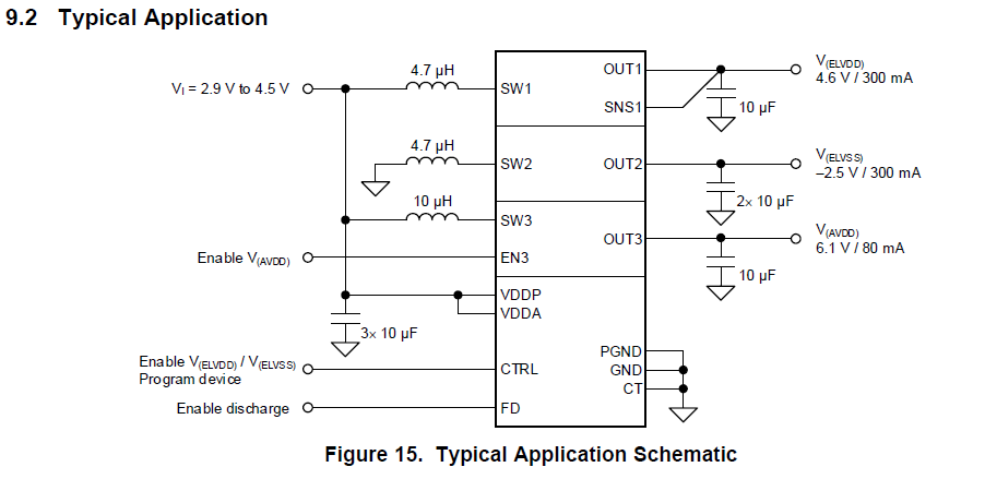

TPS65651 consulting
Other Parts Discussed in Thread: TPS65651
Hello
I want to check if there will be some bad risk when add external back-power supply at output pin of TPS65651 when its input pin is floating
Exg. Vi is floating, external add 4.6V at VELVDD
