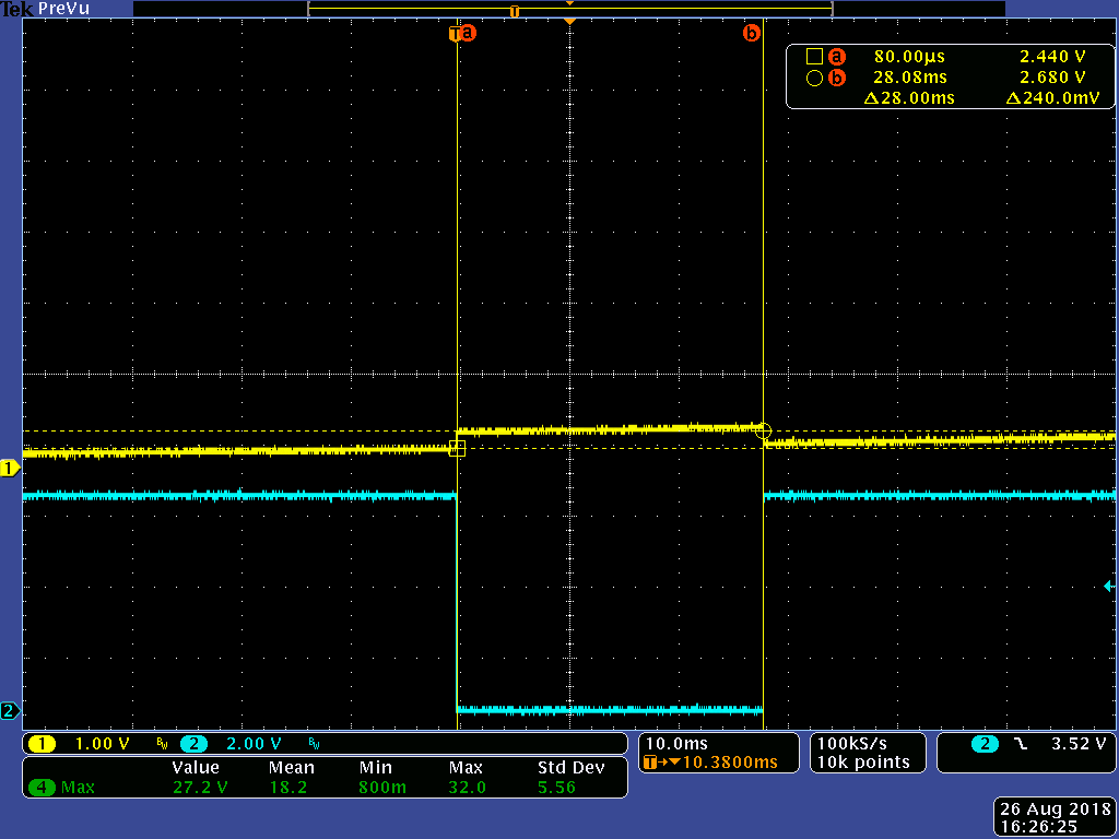

I catched a waveform just shown below. The yellow channel is CMPIN, and the blue channel is CMPOUT.
When the CMPIN is higher than 2.4V, CMPOUT will reduced to 0 last only 28ms, then CMPOUT will rising again.
When this happened, the IC may be influenced by the OVP, which is because I pulled the input voltage to 30V.
So, why the CMPOUT rising again, dose this have anything to do with OVP ?
  • It appears from the trace that the CMPIN drops almost all the way back to the original 2.440 volts at the second transition. This may be the reason for the transition of the output. Your max and min are very close to the reference point of the comparator, and there is also a hysteresis in the comparator, so this makes interpreting the capture a little difficult, but it still seems to me that the second transition in the output is consistent with the transition at the same point in the input.
    What is a little strange in this graph is that the input begins to slowly rise back towards that 2.680V point that originally triggered the comparator low, and yet the comparator output never flips back. Still, the input never quire reaches 2.680V in this graph and that, in addition to hysteresis, may explain this. I would need to see the input rise above the 2.680V point before I would be suspicious.

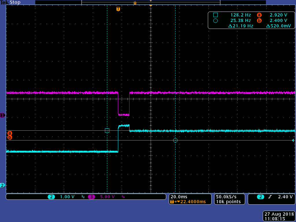

  • I placed a resistor at CMPIN, which is controled by CMPOUT, when CMPOUT is high, the resistor will connect with original resistor divider, and CMPIN will be pulled down a little bit, so that can we ensure CMPOUT won't be false triggered.
    So, the transition of CMPIN is due to the transition of CMPOUT, not the other way around. And I catched another figure which is shown below. the blue channel is CMPIN, and the purple channel is CMPOUT. I've drawn a longer time scale here. In this figure we can see that CMPIN is always higher than 2.92V after first transition. So, there must another reason cause the falling of CMPOUT.
    As for the POR which is caused by OVP, since I didn't change the register of independent comparator, I don't think there are any affect.
    And I don't use the function of path latch-off.
    So, is there any new suggestion about this problem?

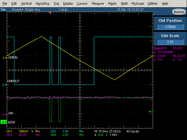

  • I was able to verify that when no battery is attached to EVM and input voltage trips the ACOVP, the comparator is disabled.  Since it is OD output with pull-up, it will pull high in this condition.  In the below experiment, input voltage is very close to ACOVP margin so that the ripple actually triggers ACOK low for two short pulses.  You can see that the comparator output is released in a 1:1 with the ACOK signal.  When this occurred, I also verified that the registers were not affected.
    (CMPIN is shown AC-coupled in the below.  It is ramping up and down between 2.2 and 2.5 V.)

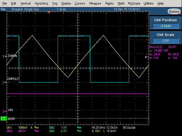

    Note that with the battery attached, ACOK/ACOVP do not have this effect on the comparator, i.e. it retains expected output even at 30V.
    Is this consistent with what you are seeing?  Can you verify that you do not have battery attached (or it is deeply discharged) and that you do not see the issue if battery is present?
    I will find out more background on why comparator is disabled in this situation and will reply back with this information.

  • Can you please repeat your test with the Low Power Enable (register 0x12, charge option 0, bit 15) set to 0? It is set to 1 by default at POR.
    In further experiment here, I have found that disabling low power mode will remove the issue, even with no battery attached.
