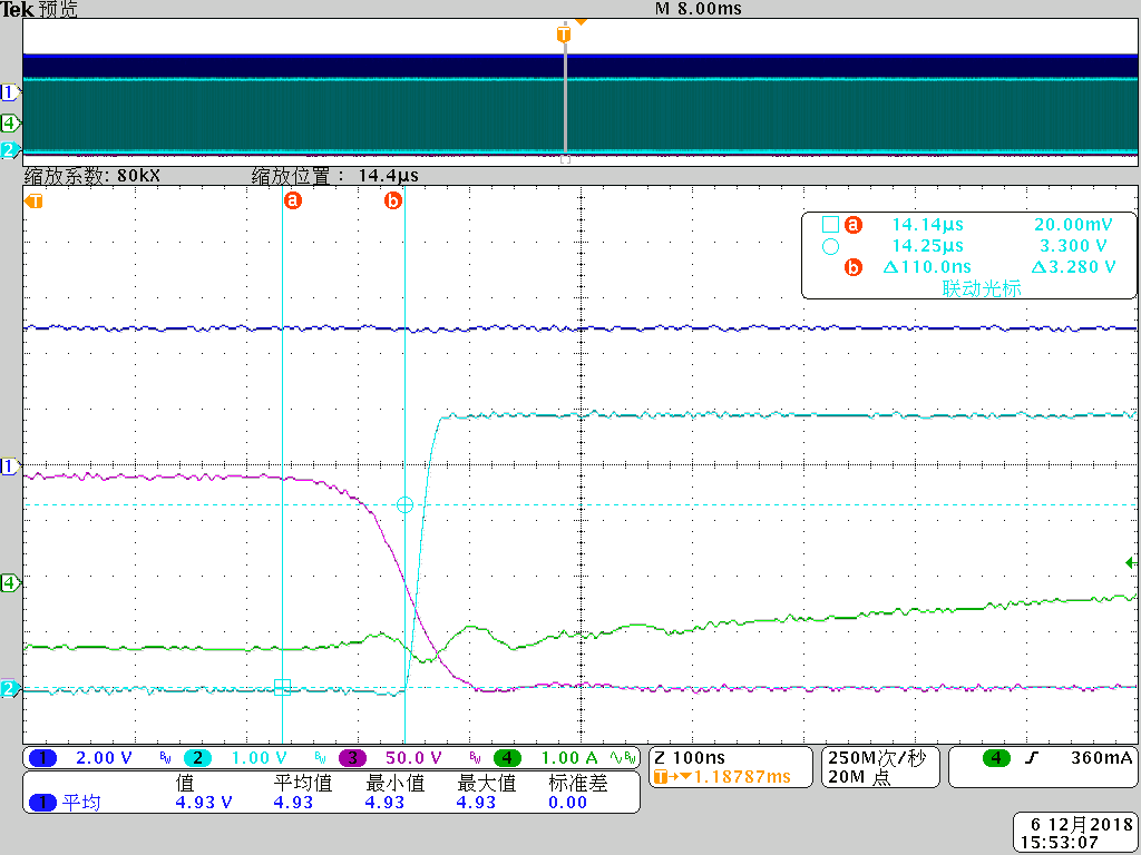

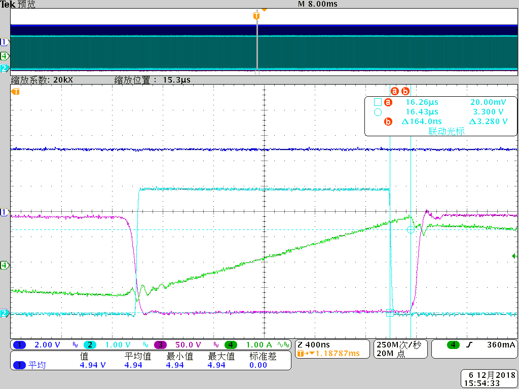

The PWML is supposed to be turned on when the primary transformer current just reaches to 0A. Right?
But I found that the PWML is turned on after PWMH turned off about 160us. Could you help explain why?
Is it possible that the TDM time is too long?
It works at 2pulses in ABM, what decides the first TDM of the of every burst packet in ABM?
Test condition: Vin=165Vdc, Vout=5V; Iout=2A;
CH1:RUN; CH2:PWML; CH3:VSW; CH4:Ipri;
