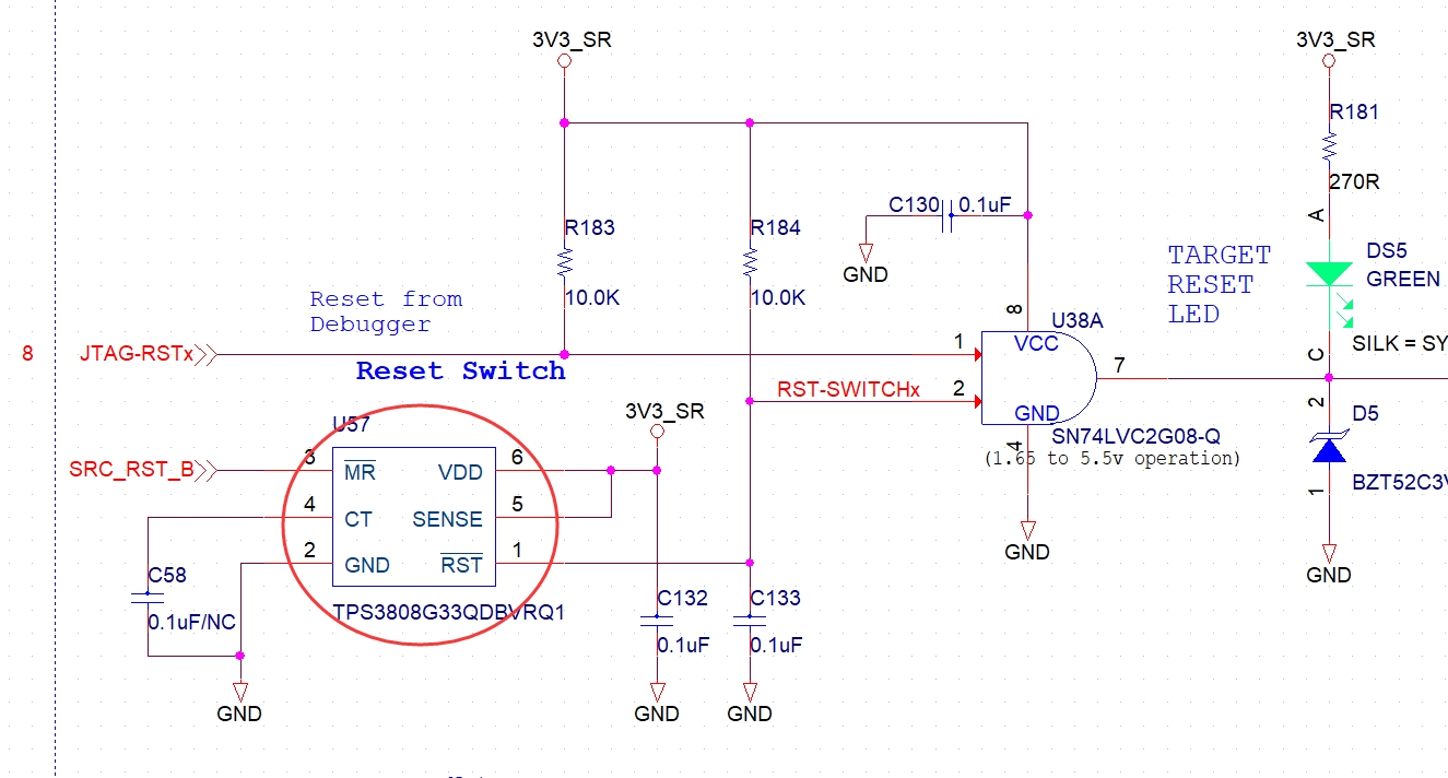

TPS3808-Q1: The system can not power on.
Part Number: TPS3808-Q1
Dears:
Could you kindly help to check the schematic as below picture:
The system can not power on, and test the voltage of 3V3_SR is OK.
The value of MR is high, however the RST is always Low.
Btw, the system is OK, if TPS3808-Q1 is not welded.
Could you kindly help to give some advice about it?
