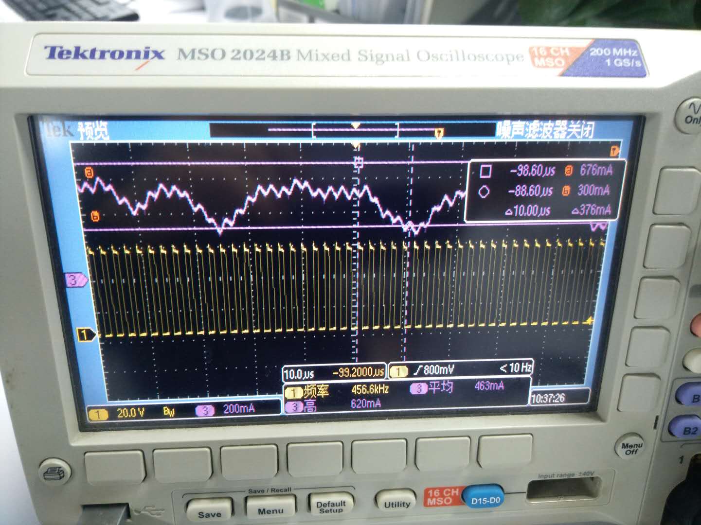

Measured waveform,Channle 1 is Mos drain waveform.Channle 3 is 12V output current waveform.
Is the current waveform normal?
Now we use this chip to power our system, and our audio is going to be noisy.
Instead of using this chip for power, we plug the adjustable power directly into the back 12V to power our system, and the audio noise disappears.
Now we suspect this power supply.

    It look like there is a 25kHz or so oscillation on the 12V output.
    I can see that your circuit does not have the cap C19 fitted in the feedback circuit.
    If you fit something like a 1nF part here you should be able to get a low frequency pole that will stabilize the loop.
    This should help with the audio noise. I think your system is just unstable .
    Hope this helps
