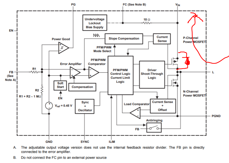

I'm a beginner in the world of power supplies.I have watched a training video on your website about DC/DC converters topologies, pros and cons.
I want to know how the boost converter Handle input short circuit and the buck converter handle the output short circuit.
Thank you by advance.

    The Boost can not support an output short.
    The Buck can not support an input short.
    As an example for the boost question, please see this design example.
    This reference design delivers an output short-circuit
    protection solution for the TPS61088 boost converter.
    This feature is realized by an over current protection
    (OCP) circuit. When the output is shorted to ground or
    the load current is higher than a certain value, the
    OCP circuit will disconnect the TPS61088 from the
    load. This solution just requires an additional low-cost
    comparator, a sense resistor, and a small sized NMOSFET. With this small amount of additional
    circuitry, the TPS61088 is protected from being
    damaged in the output short circuit and over load
    conditions.
    Basically you have a straight path from VIN to VOUT through the boost diode, when Vout is shorted.
    For the buck the issue is similar but in the other direction.
    The body diode of the high side mosfet will conduct from Vout to VIn, if Vin is shorted.
    This picture shows the intrinsic body diode of a mosfet.
    Does this help your understanding?
