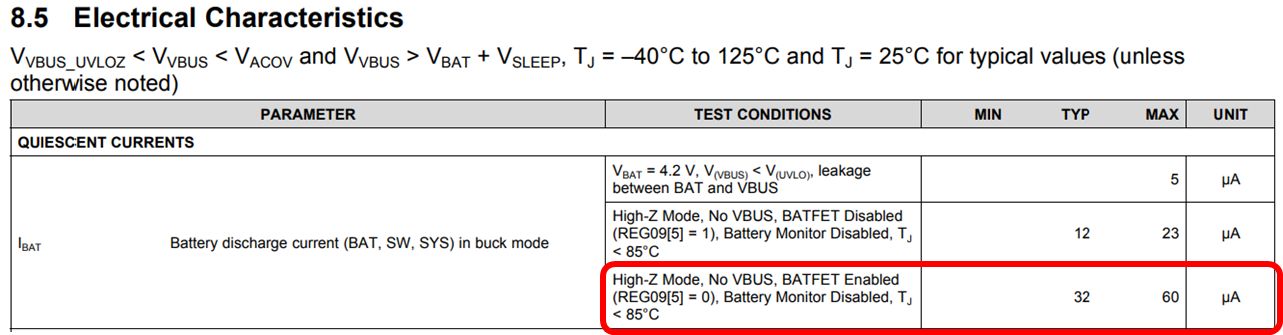

The customer would like to know the BAT pin leakage current without VBUS. I think it should be 32uA(typ) and 60uA(max) listed in IBAT spec as below. Is my understanding correct?
