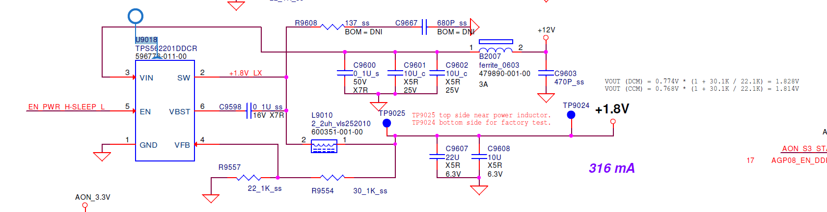

My customer has the inrush current issue for TPS562201DDCR, but there is no inrush current spec shows in TPS562201's datasheet.
My customer also require the TPS562201 high/low side MOS pulse drain current spec.
Thanks a lot.
