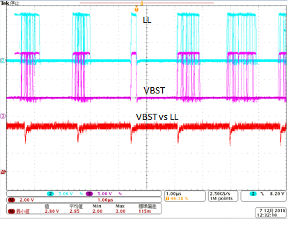

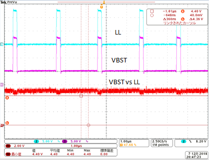

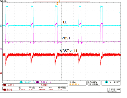

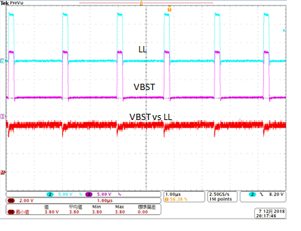

TPS53353 datasheet is described that Boot capacitor(R9) recommend is 2Ω.
①If noise and ringing condition is good, is Boot capacitor set to 0Ω, no problem?
※One customer waveform is attached below, large Boot cap will be drop VBST(with respect to LL).
 When change to less than 2.4Ω, VBST voltage was not drop.
 Customer want to confirm OK or NG for 0Ω condition. (When NG, what is the minimum value?)
・22Ω
・5.6Ω
・2.4Ω
・0Ω

  • Hi Satoshi-san,
    If noise and ringing condition is good, is boot resistor set to 0Ω, no problem? Yes.
    The VBST drop during the initial turn-on of the HS FET is normal. However, the HS FET has the turn-on threshold voltage of around 1.5V to 2V, so to be on the safe side, I would keep the drop above 2.5V. Please keep in mind that higher Rboot will effect the efficiency as well. You can also use the snubber circuit to minimize the switch node ringing to stay within your specification.
