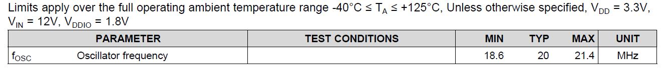

Hello all,
I would like to know the switching frequency variation (min/max) when setting the frequency to 400kHz (BST_FSET=4.75kOhm+/-0%) and 2.2MHz (140kOhm+/-0%), disabling spread spectrum. Does it depend on the load or input/output caps or others?
Thank you,
