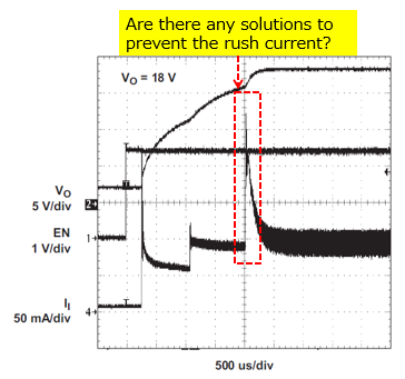

We got a question from the customer about TPS61041.
Could you help us?
[Question]
According to the datasheet, the rush current of the inductor current is occurred at start-up.
- They assume the finish of the soft start period is the reason why this phenomenon happens. Is this their understanding correct?
- Is there any solutions to prevent the rush current?
They are using the IC on thier proto type. They have problem which is the source current of the battery beyonds the rating due to this rush current. Therefore they would like to know how to reduce the rush current.

  • Hi Tateo,
    the understanding is correct.The reason is that the device release its current limit to 400mA. I think you can try TPS61041, which has smaller peak current, 250mA. other solutions could be smaller inductor, such 4.7uH or lower; larger input capacitor and smaller output capacitor.

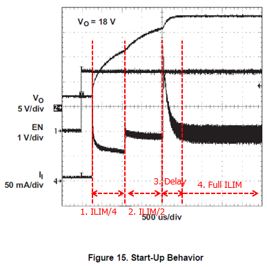

  • Hi, Thank you for your reply. I need to clear my head. We assume this phenomenon is occurred by following steps.
    1. IC is enabled
    2. Start the soft-start (starting from ILIM/4 for 256 cycles, then ILIM/2 for the next 256 cycles)
    3. Delay time to enter the full current limit (this causes the rush current)
    4. finish the soft-start period (release full current limit)
    The soft-start period is determined by clock cycle(256 + 256 cycles). Therefore we assume the IC can't extend the start-up period. And the rush current seems to beyond full current limit. We assume the delay time to enter the full current limit causes the unregulated the current limit. Is this our understanding correct?
    If our understanding is correct, we need to shorten the delay time. Are there any solutions for that?

  • Hi Tateo,
    the inrush current is 250mA, which is still below the peak current limit of this device, 400mA. that is also why I suggest 250mA device TPS61041. The current limit is the same for the period 3 and 4. the input current is determined by the loading in the period 4. it doesn't reach the current limit.
  • Hi, Thank you for your reply. The topology of this IC is peak current limit control. Please refer to section 7.3.1 in datasheet. So I believe the inductor current reaches the full current limit in the period 4.
    I think the range of Il is a typo...
    tateo
  • Hi Tateo,
    the current waveform in the startup is the input current, not the inductor current. this is why we see approximately 100mA after startup finish.
  • Hi, I think the input current is same as the inductor current. Please refer to attached file for the details.
    TPS61041 TINA Startup_18DEC18.pptx
    tateo
  • Hi Tateo,
    in the simulation, the output impedance of the power supply is zero, so all the inductor will flow through the power supply. that is why input current is the same as inductor current in the simulation.
    however, in real world, the output impedance of the power supply is normal higher than the input capacitor in the switching frequency. so the inductor current ripple will flow through the input capacitor, and the average current flows through the power supply. then we can see the difference between the input current and inductor current

  • Hi, Sorry to the delayed reply. I checked the inductor current and the input current on EVM. The inductor current smoothly move to full current limit from ILIM/2. Therefore I assume to need slow slope of the output voltage after finish the soft-start.
    So I suggest the application report(SVVA307B) to the customer. But I'm concerned the output voltage ripple is increased due to Cff is isolated by diode...
