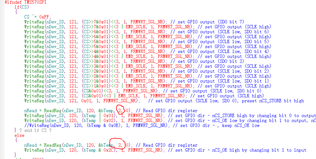

2.The code in function     void EMB_SetCS(int nDev_ID, int CS)
nRead = ReadReg(nDev_ID, 120, &bTemp, 2, 0); // Read GPIO dir register
No.120 register is 1 blen,not 2 blen.
Does this affect the operation of the code?

    For question #2, the ReadReg function you highlighted is there to read the GPIO direction register and then "OR" the data with the new data that you want to write. That way the previous settings for GPIO direction register (Register addr. 120) won't get overwritten and you only modify the specific bits you want to write to. Please implement your ReadReg function reading only byte 120 (bLen = 1), and not 2 bytes as shown in the example code. Thanks for highlighting this.
