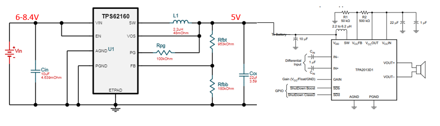

hi Team:
TPS62160 Vin voltage is 6-8.4V,output voltage is 5V, and the load is TPA2013d1,at - 20 ℃ ,the TPS62160  output voltage is  2-3V?    why?
