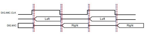

    I wanna now, can 2 analog input sampling at the same time or is it has to be one after other.
    For example if ship has one ADC it take left channel sample, after a time delay(migth be half of sampling time) rigth channel sample. We can't tolarate this much time delay.
    Digital mic. inputs of chip:
    Can we take left and rigth sample (from analog input) at the rising edge of the clk.
    Our project require conqurrent sampling for both channel.
    Thanks...

    Thanks for your help. If i undestant correctly you say data interleaved/delayed but.
    referring to page 691 of swcu050e.pdf (Technical Reference Manual ver E):
    Option 1: Four simultaneous multimedia analog channels (four multimedia DACs and no modem voice
    path) and two simultaneous ADCs or four channels coming from digital microphones.

    Again i'm sorry for my weak explanations.
    But   is right. I'm not asking digital mic.s, i only used that figure to explain my problem(There is time diagram for dig. mic but not analog inputs).
    I'm asking Audio ADC. To be clear:
    If i will use AUXL and AUXR inputs or Main mic and sub mic inputs.
    Can i achieve concurrent sampling, is there any time diagram or how to do document(for exp. programming referans).
    Is there any further explanation other then i quote upper comment.
    Thanks...
  • Hi Volkan,
    OK, sorry for referring to the digital microphone.
    On the device the analog signal is sampled at the same time. So, using the two input amplifiers you will have concurrent sampling. We do not have any plots to demonstrate this though. It is done in design and there i sno external programming required to achieve this.
    Gandhar.
