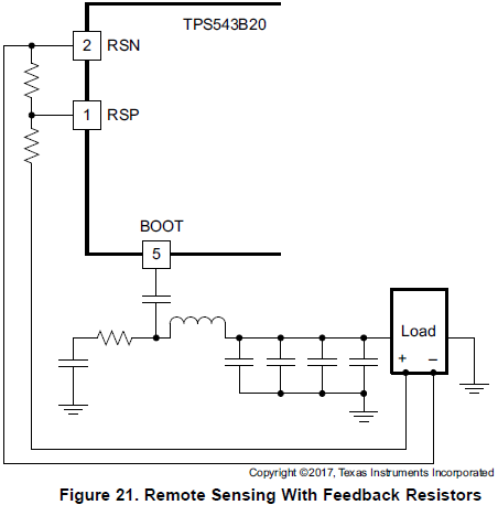

Could you tell me about Remote Sensing With Feedback Resistors?

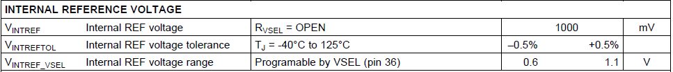

In this configuration, the accuracy of Vref is 0.5% @Tj=-40 to 125℃.
Is my understanding correct?
Customers want to know how to think about accuracy when using Feedback Resistor.

    The accuracy of Vref is still the same as on EC table. However, the output voltage accuracy will be higher than +/-0.5% due to the tolerance of external resistor divider network. The resistor tolerance can be find in 0.1%, 0.25%, 0.5%, 1% or more options.
